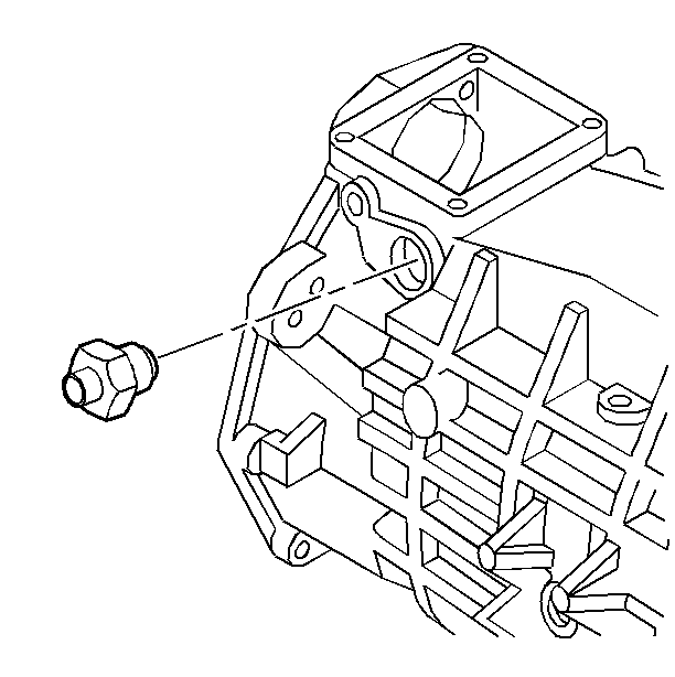

Keep in mind the trannie case is aluminum and the detent bolt is located up high on the right back end of trannie so not easy to get to and if your not careful you will cross thread and be in big trouble so take you time . Detent bolt location :
[Linked Image]

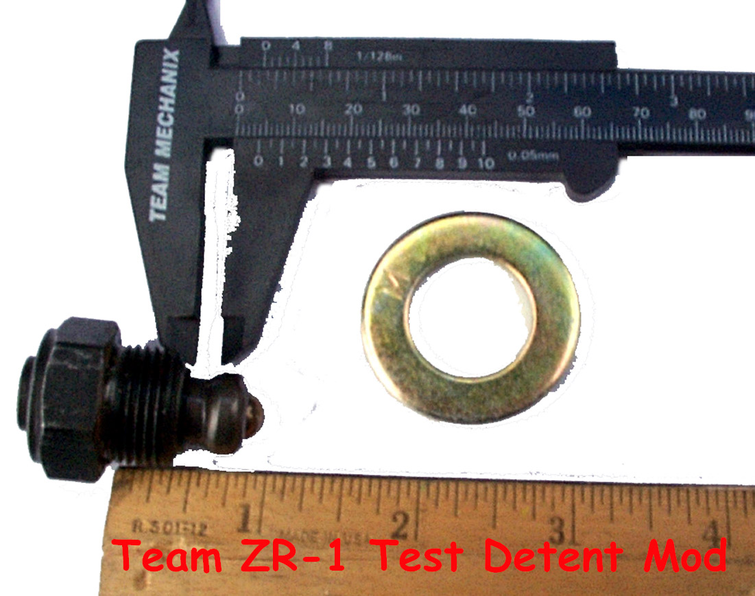

Make sure you use the image below to see that the detent part of the bolt only moves about 4 mm and if you use too thick of a washer then there will only be about 4 threads left to screw into trannie case and over time come out.
You also need to use a sealer on threads when re installing and do not over tighten
[Linked Image]
I spent a whole day looking at the function, installing the shim (washer) and testing.
It will make the shifts smoother and less effort but also will now rely more on you where neutral gate is.
You might want to test it and then simply remove the shim if its not to your liking but in no case remove the detent pin and replace with a short bolt that is nothing more then to plug the whole in case with zero detent

Due to where its located you cannot get good sight or angle and because the trannie case is alumimum I would not use more then maybe 20 ft/lbs. Use a threadlocker to prevent it getting loose.

Yes without the neutral gate feel you may find when going for a gear like 1st that your not sure your in that gear.
I'd say test drive for about 1 week and see if you get used to the feel and see if any issue on downshift for I found sometimes going for 6th shifter was really headed for 4th.

This would be a T56 issue and not a model
I would assume on F-body it may be easier since on the C5 the MN6 is in the rear and doing this on a floor jack and laying under the car the blood rating is a 3 ( how many areas on my hand that draws blood) and a pissmeoff factor of a 5.
On the C5 being you cannot see the dentent bolt or get a light up there the hardest part is re-installing the bolt for you do NOT want to cross thread or you'd be in big trouble so getting bolt hand started is a must and a bitch.
I would do this without a doubt while trannie is out for then its a 3 minute task.
