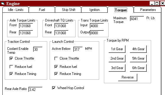

This is confirmed in using LS2edit we see new launch parameters where PCM can control drivetrain protection by reducing fuel,timing or closing the butterfly of TB via ETC.

Can you lower the speed in the launch control box, to make the mph lower or could you toggle off the reduced throttle and fuel trims with LS2 edit. That might solve some of the launch problems you have found.

The setting your talking about only is the trigger when launch control works so if you changed the stock setting which you see at 317 MPH to lets say 5 MPH then it would work from 0 to 5 MPH and not above that and as you see the car is at zero MPH at launch so lowering the value would not help.
Either GM did not also include a table with multi values to tweak this condition or LS2edit has not found those tables.
