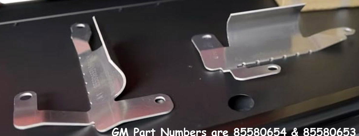

One of the downsides of having the engine in the rear is that cooling the hot engine bay and heat soak
Without proper ventilation, heat from the engine’s headers, catalytic converters, & exhaust can cause heat soak,
which can significantly lower your Corvette’s performance and longevity.
For some reason, Corvettes destined for the European market are equipped with a GM OEM cooling mod straight from the factory, and the benefits of these two parts easily-installed air deflectors can be significantly lower
These air deflectors mount under your car, and they are designed to route cooler air into your engine bay
The good news is you can order these parts from your dealer’s parts counter, and they are easy to install.
The GM Part Numbers are 85580654 & 85580653. I did a lookup of them on GM Parts Direct, and they are called “F Deflectors.”
Together, they average around $125 each so around $250 for the pair or make your own

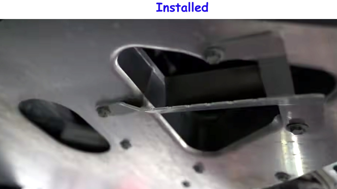

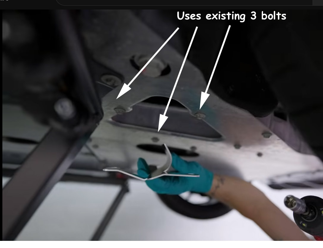

These air deflectors are metal components that easily mount using existing hardware on the skid plate under your Corvette, and the scoop design sends cooler air directly into openings of your engine bay where your headers and catalytic converters create some of the most heat.
Once the air deflectors were installed, sloppy measurements by a C8 owner on 2 different days after a drive & C8 Owner claimed that it significantly reduced temps around his engine bay:
• Left side carbon fiber engine bay area: 87.8°F (down from 132°F)
• Intake cover: 97.9°F (down from 154.1°F)
• Headers: 186°F (down from 222°F)
• Trunk area: 104°F (down from 146°F)
These claimed results show temperature reductions ranging from approximately 42°F to over 56°F in hotter areas.
Left and right side part numbers :
https://www.gmpartsdirect.com/search?search_str=85580654
And
https://www.gmpartsdirect.com/search?search_str=85580653
This needs better testing and long term use to see if the directing of cooler air is also not directing dirt upward into the bay
Claims these 2 parts would install on all C8 models & years
#7080 - 58 minutes ago Re: Claimed GM parts help cool the C8 engine bay [Re: teamzr1]
Posts: 6,016
Posts: 6,016
Located these 2 parts on Amazon which states :
About this item
• Fitment: The underbody rear air F deflector shield compatible with Chevrolet C8 Corvette 2020-2025.
• Direct OEM replacement (Part# 85580653/4) for ALL 2020, 2021, 2022, 2023, 2024, 2025 Chevrolet Corvette C8 model.
• Material: High-Impact stainless steel shields critical rear underbody components against road debris, rocks, and corrosion while maintaining lightweight performance.
Reduces Air Resistance: Airflow deflector design reduces air resistance and turbulence.
• Increase downforce when driving at high speed to enhance the stability of road/track driving
• Quick Installation: Installs in minutes and reduce maintenance costs – protect your car's performance with this affordable solution.
• Quality Service: If you encounter any problems after purchasing the product, we have professional customer service staff to solve for you.
Thus, this was not designed as others claim as for cooling, but as it states above
