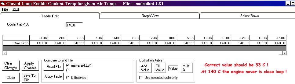

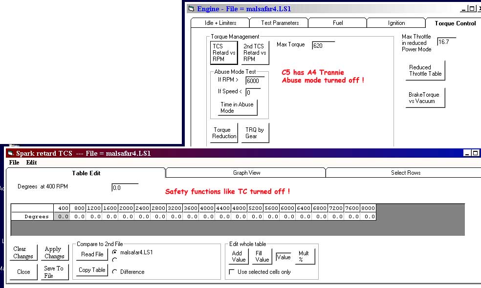

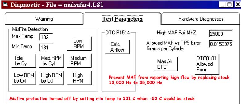

The following is from a vendor called PCMFORLESS
The customer had a Procharger installed and this PCMFORLESS does "canned" tunes in the blind by customers shipping the PCM to them
The car owner now has a bunch of problems not only with engine but even the A4 transmission is not functioning correctly.
This is not only lazy tuning methods but total lack of respect for the customers cars for they turn off error codes so that owner does not known when engine is too lean, has misfires, etc
but also turns off safety features and never allows the engine to run in closed loop :
Refer to the RED content in each image which is looking at just a few of the PCM tables this vendor changed.
This engine would not have lasted long, esp since boost is around 18 PSI !
