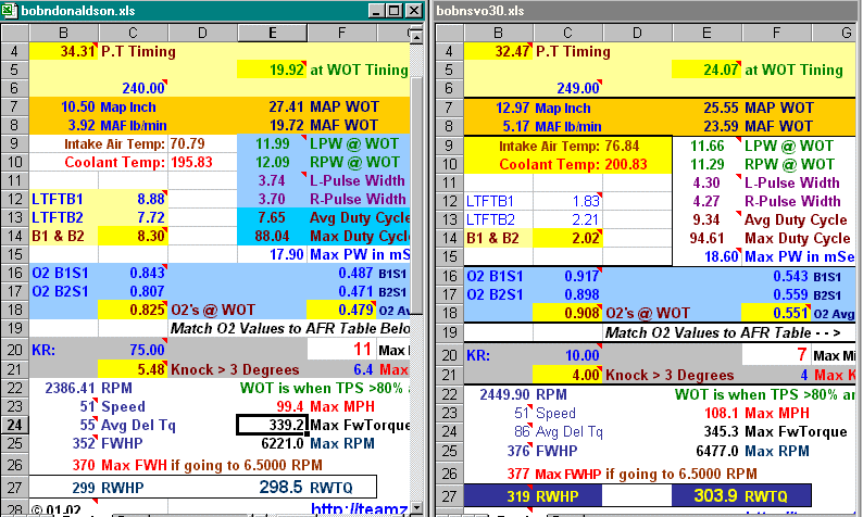

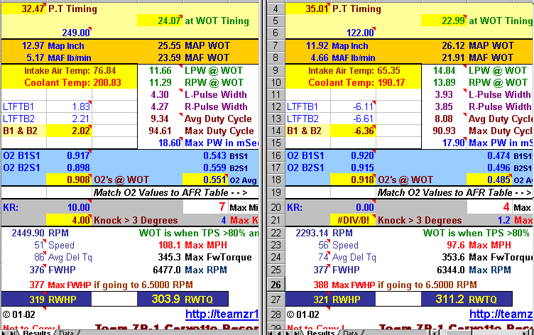

Here is report results of analyzing teammate Bob's stock '01 Z06, adding a Donaldson airfilter and then installing 36 lb injectors.
Stock : PCM calibration Donaldson airfilter - PCM Calibration
[Linked Image]
After 20 miles of using Donaldson Inslalled SVO 30 Injector.
[Linked Image]
Horsepower and Torque increased.
Thus so far a gain over stock of 22 RWHP and 12 RWTQ. Once he installs the MAFT and adjusts properly to gain good WOT timing the gains will be even better.
