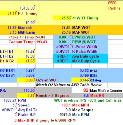

Here is at the Drags last month using powerloader junk PCM code, and MAFT and then after I sh&t canned the powerloader and did my own PCM calibrations.

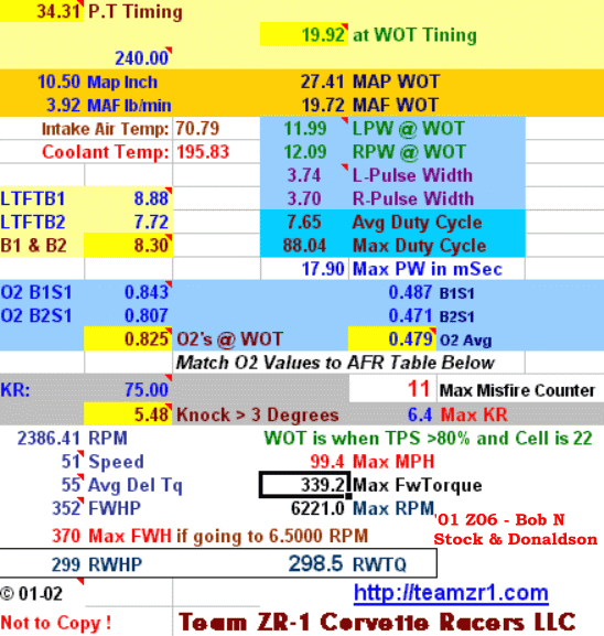

A '01 Z06 after switching to a Donaldson airfilter. With stock filter LTFT was 3% lean and after LTFT goes to 8% lean, thus needs larger injectors.

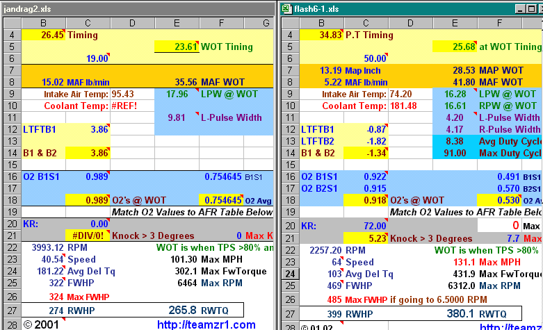

A '02 Z06 stock and way too lean !
