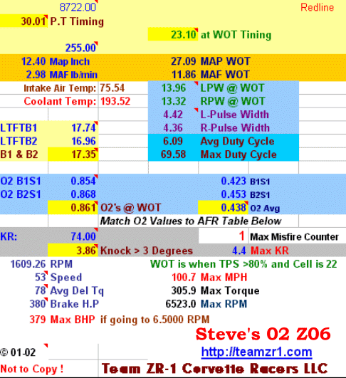

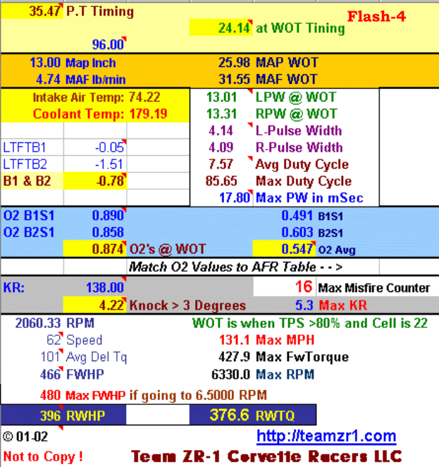

Here are Teammates Lonnie and Steve's '02 Z06's
One is stock with a dual K&N Filter, the other has also SVO 30 injectors and tuned using a MAF translator and it was not the final tune so the numbers are even better now.
Which would you prefer ?
[Linked Image]
[Linked Image]
Compare at the bottom of each as to torque and brake HP.
