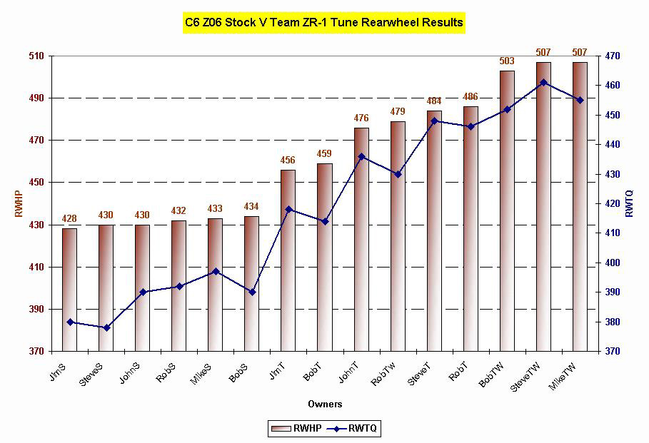

#1754 - 07/01/07 01:22 PM Comparing 6 C6 Z06s stock and then after we tuned
Here is a fair shot at six C6 Z06s.
Swowing is
S is for stock
T is for after our 1st pass of tune
TW is if we then tweaked the tune.
This shows for best performance after the main tune is done and PCM does it's relearn then one more tune cyle is done to tweak what needs it.
All values were gotten from using a Ease OBD-II scanner in GMLAN mode and we have one cross check after tuning where Z06 owner used a load bearing dyno that was local to us.
Values when scanning were done are UNCORRECTED
Notice Rob's results, you see a loss in performance after tweak was done he forced the muffler damper to stay open all the time
Also Steve added that Halltech aircleaner and so called Aircharger and no real gains from it.

The purpose of me going back and looking at 15 spreadsheets of the results above was to see what the gains were and see if plotting 6 Z06s all reacted about the same ( not considering where each car is to elevation, weather and different types of gas) to tune changes.
Clearly as I have always said and proven again you cannot bang a tune out on some chassis dyno, you need to do main tune, drive car a few days for PCM to relearn and adjust and then retest and tweak the tune.
Two of the above did not get that as in 1 owner decided after main tune to put in a CAM and other mods and not get a tweak done and it shows in the results above.

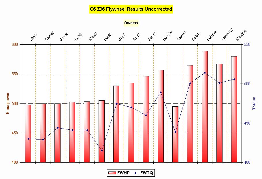

Here is the uncorrected flywheel numbers as PCM reported via OBD-II
