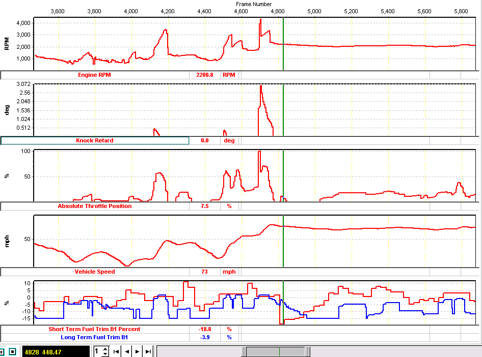

Attached is two OBD-II scanner recordings owner did once engine failure was repaired and doing a cruise still using the so called custom tune over 2 different days to verify engine and the collected data.
It is clear that even a low engine loads the fuel trims were as much as -16% too rich which does not help washing down the piston rings, exhaust makeup to sparkplugs, O2s and CATs
Not what you'd expect from a custom tune puke

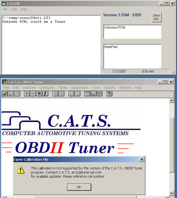

This verifies shop or whoever they had tune the PCM locked it so that no others could download the PCM to either see the tune or to properly tune it.
This caused the C5 owner to yank the PCM out and ship it to us.
We then checked with LS1edit and Tunercat and as seen below both tuner programs could not even tell what type of car or year.
This forced us to purchase a new PCM, tune it from the blind, ship back to customer
He then had to go through the car's relearn process, do scanner testruns and then we had to tweak the tune and via email send him updates to clean the mess up
This cost customer more down time until this all was done and the additional costs.
Uncalled for shops to lock PCM so that only they can access the PCM calibration. Generally I see this when the reason for locking is so no one can see how bad the tune was and what they did wrong or lack of real tuning experience causing poor tuning which can cause major engine damage

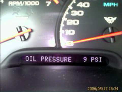

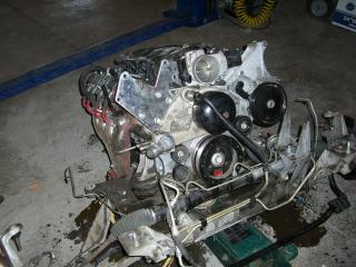

These are images taken from this C5 after 100 miles on new engine and the lazy and non experienced work by this shop
Notice the rear O2s, they cut the wires off to leave O2s in pipe rather then doing the right thing and keeping them functional but at least if they were not going to use them was to seal the bungs rather then cut the wires which BTW with the cut ends become a EMI/RFI noise path to confuse then PCM
Notice at idle the engine only had 9 PSI oil pressure ! puke
and then the damage in only 100 miles to the main bearings of crank !
Pure and simple, owner paid over $10,000 and got a new engine blown to shit. sex
