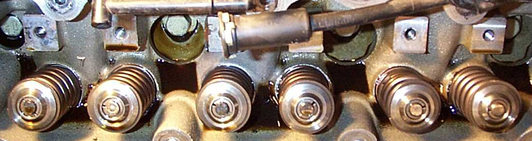

Customer bought the springs, keepers, retainers and keys from Crane CAM and we used the spring tool of their's that clamps down over both springs for 1 cylinder.
The tool is not perfect but much better then the single spring tool, esp as we did this with heads still on engine as seen on far right of image below
Notice in other image the tops of valve stems on a few beat up and the spring 2nd from right is broke

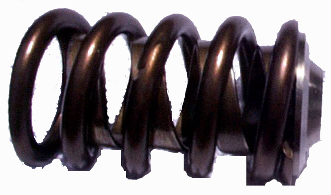

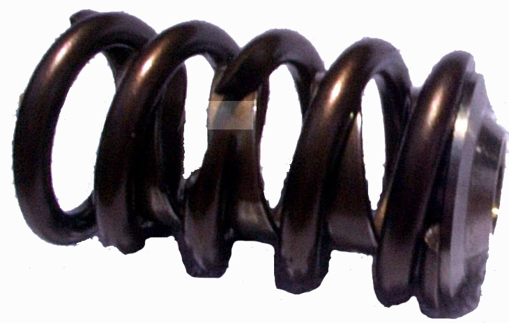

The spring on the left is what the height should be
Spring in middle is weak and has lost some height
Spring on right is broke in the center

WIth the spring installed you could barely see it was broken
Like a clean break of spring being to hard and just cracking
