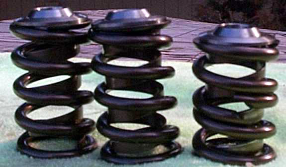

The spring on the left is what the height should be
Spring in middle is weak and has lost some height
Spring on right is broke in the center

WIth the spring installed you could barely see it was broken
Like a clean break of spring being to hard and just cracking
