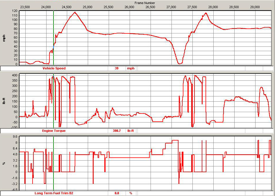

Here is another from today. I didn't have the mic on so there is no sound. As you can see from watching the speedo traction is a major problem right now.
[Linked Image]
#2024 - 10/13/07 11:02 AM Re: Testing web camera while using EASE [Re: ]
Posts: 5,848
Posts: 5,848
I can tell you had Warp set at 20 mSec so collected 40 frame second. Also see the water/methanol was on but I would bring the Full setting on at a bit lower value to allow pump to go full flow sooner.
I can see lots of torque/wheel spin issues with the increased performance. At one point losr -100 ft/lbs due to wheel spin going from 2nd to 3rd gear as seen below

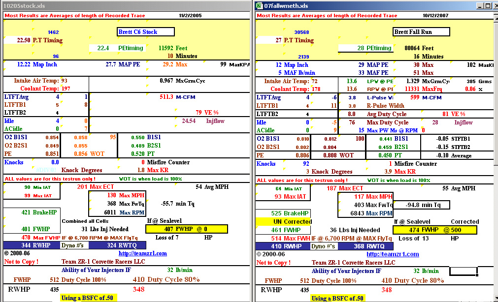

Also here is a compare of how your 2005 did when stock ( on left) and then as of today's run with our custom tune and w/meth on
