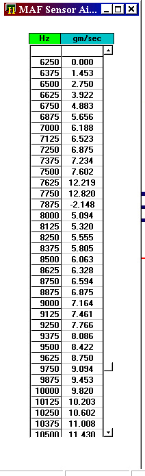

After so called hot mods like yanking the screen out of the MAF,

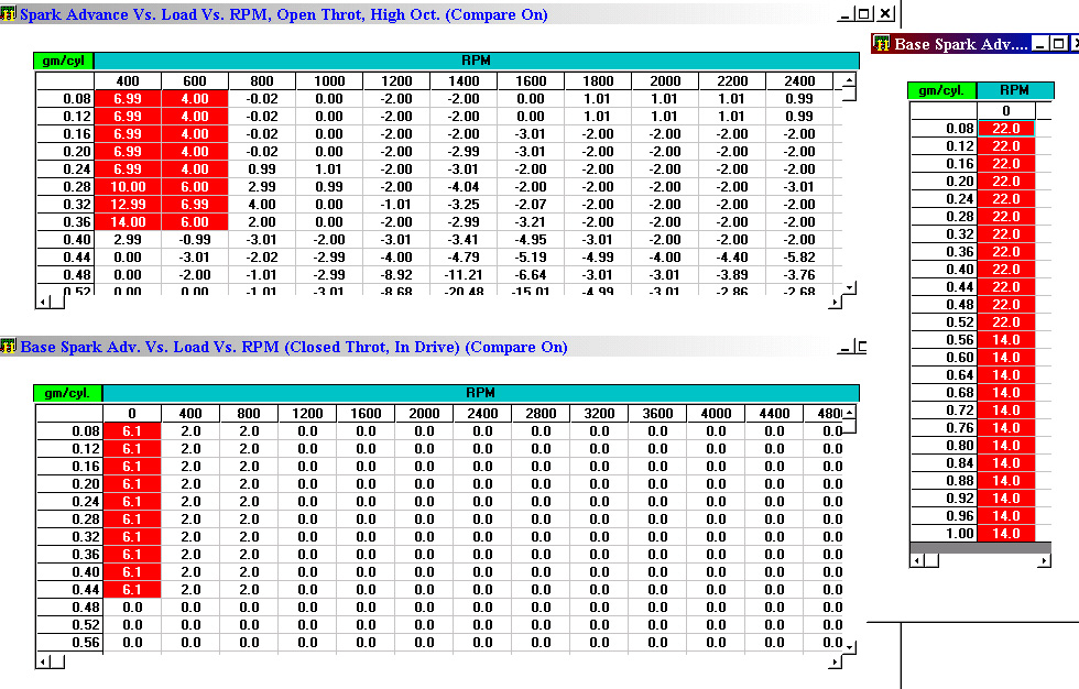

Owner takes car in for EPA I/M 240 smog testing that includes testing at 15 and 25 MPH on a threadmill. Car fails both tests. sick
Owner contacts us and we have him meet up with one of our teammates who does a testrun with a Ease scanner recording all engine functions.
We analyze that data and find the engine is running very poor including way too rich for all NON WOT conditions, idles too high and engine timing jacked way up.

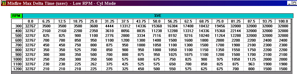

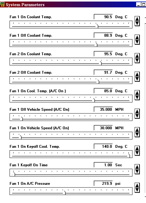

Owner sends us the PCM and we download it to analyze the tunes that had been done. Here is just a few of examples of lousy tuning.
The C5 owner has gone through hell as 2 so called pro tuners charging high prices jerk him around and in the end had to start all over again to get a custom tune from us.
In reviewing the Ease scanner data found was all sparkplugs hand tightened, wrong push rod lengths, bad front 02s and totally incorrect tuning.
Note :
the values in red in timing tables is the amount in degrees that was added over and above the stock values

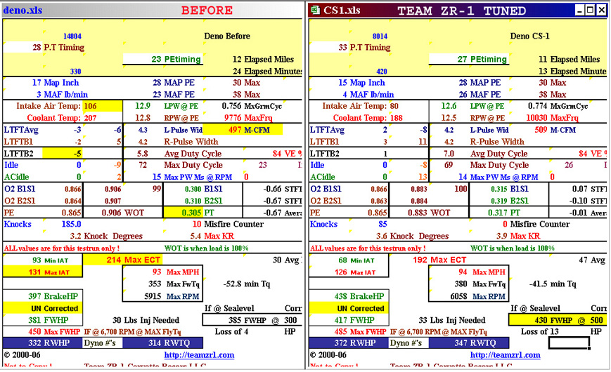

Here are the results after we cleaned the tune up :
Results from our custom tune is on the right side, the end results of 2 other tuners who had hands on with the car on the left side.
Owner simply did a Scanner recorded testrun and sent us that recording and the PCM to us since he was not local to us and in the end with proper methods of analyzing scanner data we custom tuned the PCM off board.
Some of the changes :
Before - WOT timing 23 deg, Torque 353 ft/lbs, HP 353
With our tune : WOT timing 27 degrees, Torque 380 ft/lbs, HP 430 and 100 degrees less timing loss due to ping.

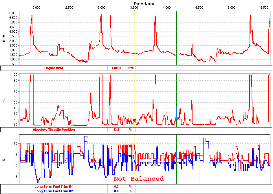

One problem that has to be resulted, in proper analyzing the scanner data we see the left head at times is 7% leaner then the right head. This is causing the ping.
Suspect is due to the lousy design of LG headers and using rear O2 into the front locations is their special air channel wires are too long so excess wire is bundled up which crimps off the requires air source O2s need and also possible they used the wrong exhaust manifold gaskets causing slight leaks.
