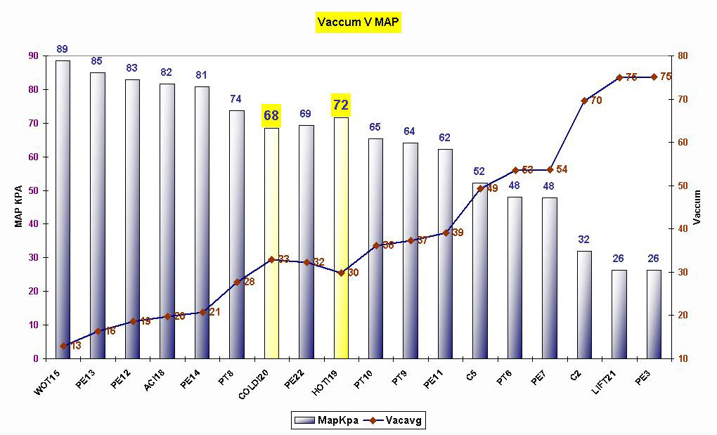

Looking then deeper into the recorded scanner data we see that when idle ( cells 20 and 19) that MAF which normally would be around 35 KPA is around 70 KPA !
Part of this would be due to the LSA of CAM but not this badly.

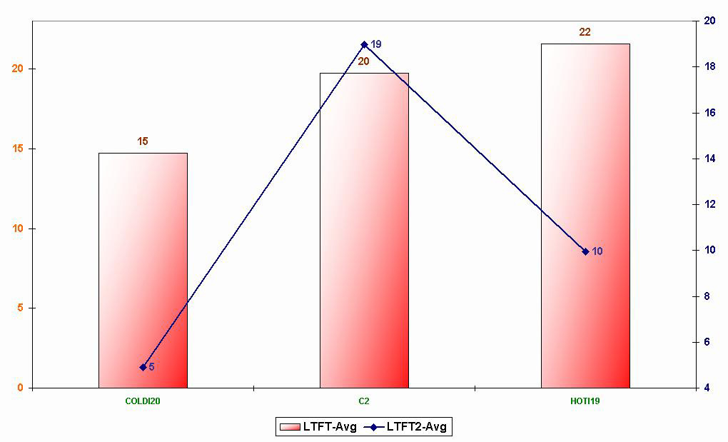

Also notice the fuel trims left head / right head are no where near equal
