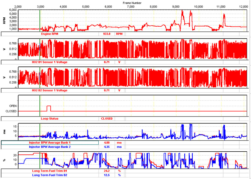

#1925 - 08/11/07 01:41 PM Bad end results with the wrong mods used
What happens when lousy header design and bad choice of CAM is used:
Code
RPM	TPS	CELL	Timing	LTFTB1	HO2B1S1	PWB1	LTFTB2	MAF	PWB2	HO2B2S1	MAFRQ	MAFgrms	INJDC	grmcyc	CFM	VacKpa
916	18	6	20	24	0.840	4.9	9	1	4.4	0.750	4135	8.45	3.4	0.138	77	37
916	9	20	20	24	0.310	4.9	9	1	4.4	0.420	4135	8.45	3.4	0.138	77	37
916	9	20	20	24	0.310	4.9	9	1	4.4	0.420	2719	8.45	3.4	0.138	77	37
916	9	20	20	24	0.310	4.7	9	1	4.2	0.420	2719	8.45	3.2	0.138	77	37
916	9	20	20	24	0.310	4.7	9	1	4.2	0.420	2719	8.45	3.2	0.138	77	38
848	9	20	21	24	0.310	4.7	9	1	4.2	0.420	2719	8.78	3.0	0.155	71	38
848	9	20	21	24	0.350	4.7	9	1	4.2	0.400	2719	8.78	3.0	0.155	71	38
848	9	20	21	24	0.350	4.7	9	1	4.2	0.400	2746	8.78	3.0	0.155	71	38
848	9	20	21	24	0.350	4.7	9	1	4.2	0.400	2746	8.78	3.0	0.155	71	37
835	9	20	21	24	0.350	4.7	9	1	4.2	0.400	2746	8.82	2.9	0.158	70	37
835	9	20	21	24	0.340	4.7	9	1	4.2	0.400	2746	8.82	2.9	0.158	70	37
835	9	20	21	24	0.340	4.7	9	1	4.2	0.400	2753	8.82	2.9	0.158	70	37
835	9	20	21	24	0.340	5.0	9	1	4.4	0.400	2753	8.82	3.1	0.158	70	37
835	9	20	21	24	0.340	5.0	9	1	4.4	0.400	2753	8.82	3.1	0.158	70	31
763	9	20	21	24	0.340	5.0	9	1	4.4	0.400	2753	8.92	2.8	0.175	64	31
763	9	20	21	24	0.310	5.0	9	1	4.4	0.370	2753	8.92	2.8	0.175	64	31
763	9	20	21	24	0.310	5.0	9	1	4.4	0.370	2769	8.92	2.8	0.175	64	31
NOTE: the sliders are active so you can move through the data
Notice how lean the left head (LTFTB1) fuel trim is to what the right LTFTB2 is.
Stock LS1 with no CATs, mufflers, crappy LG headers with a CAM grind of :
237-242 605-610 112 LSA
STAGE 2.5 5.3 HEADS
UNDER DRIVE PULLEY
STOCK INJECTORS
LS1 INTAKE

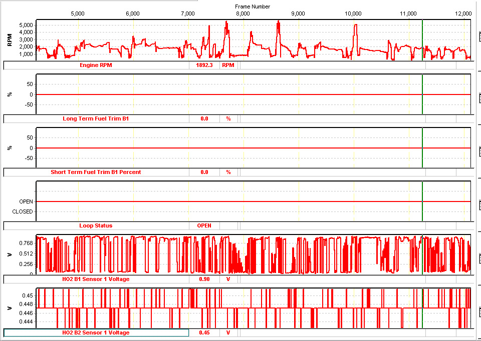

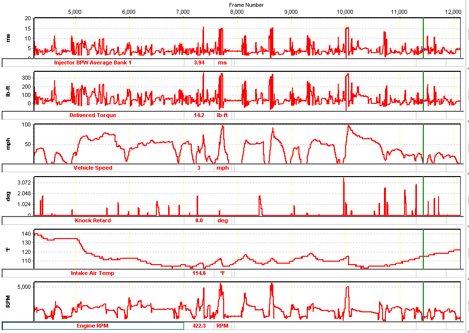

Here is more PCM data to analyze and follow how using a OBD scanner pinpoints problems without ever seeing the car.
Owner had the above mods done and then some so called pro tuner tune the PCM
Car ran quite badly. Review the mods installed and then the performance as looking at the torque values recorded.
Notice in top graph if you do not analyze all the data as in this case you would not see any real issue
Now look at the 2nd graph and you notice PCM never goes into close loop, the fuel trims show no values all due to one O2 not functional
Now compare both front O2 sensors and you see the right (B2) O2 never reports over or under 450 mvolts.
By seeing they I then called the owner and the shop he went to to find out the problems and told then what the scanner data had told me and shop looked to find both front O2s were plugged into the other sides wiring to PCM.
