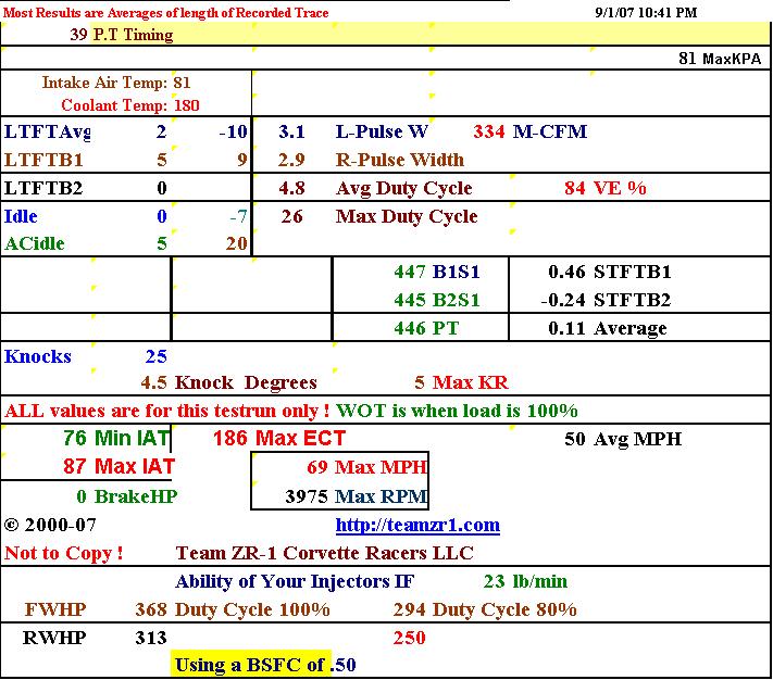

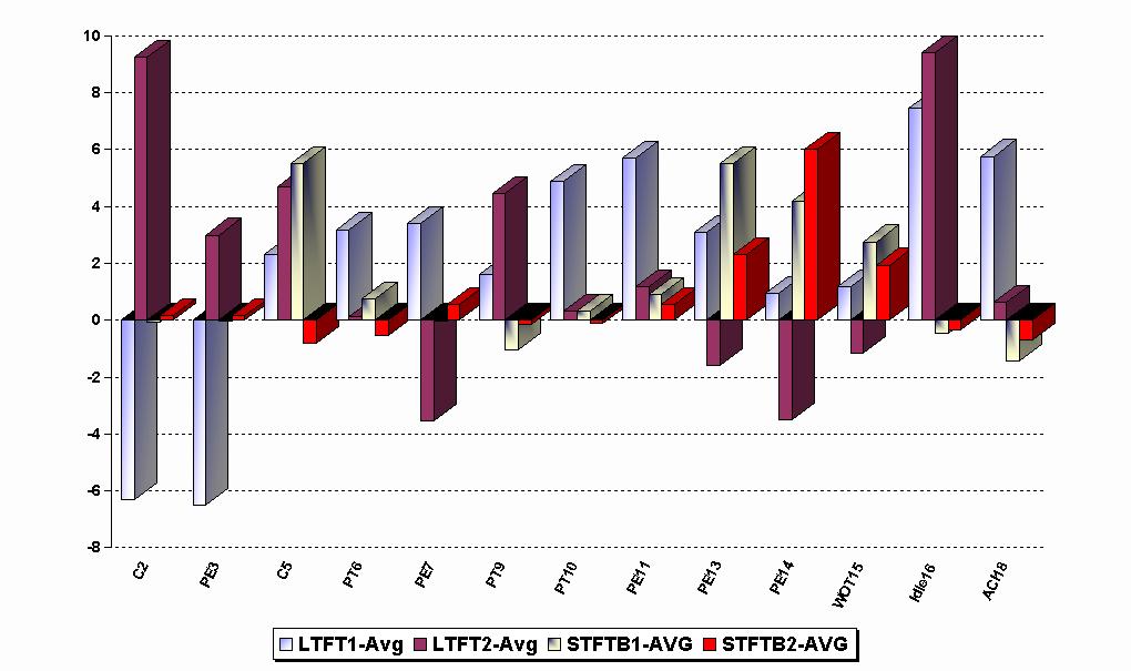

This car is being tuned now but if scanner data is analyzed you notice there is a problem that must be corrected first as why left and right fuel trims are not equal

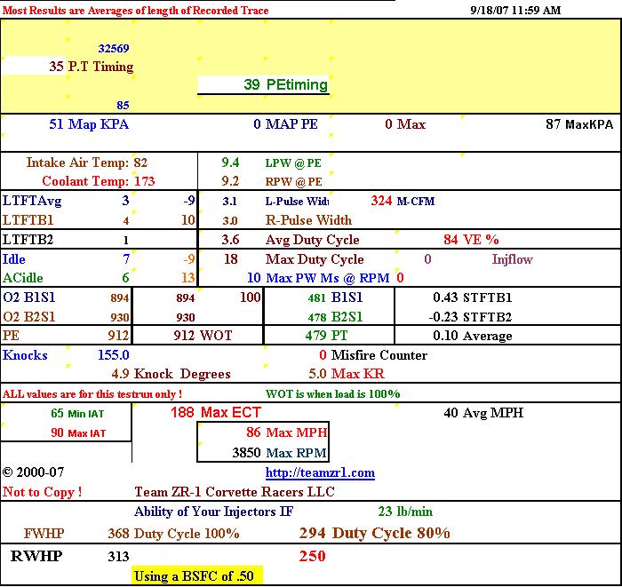

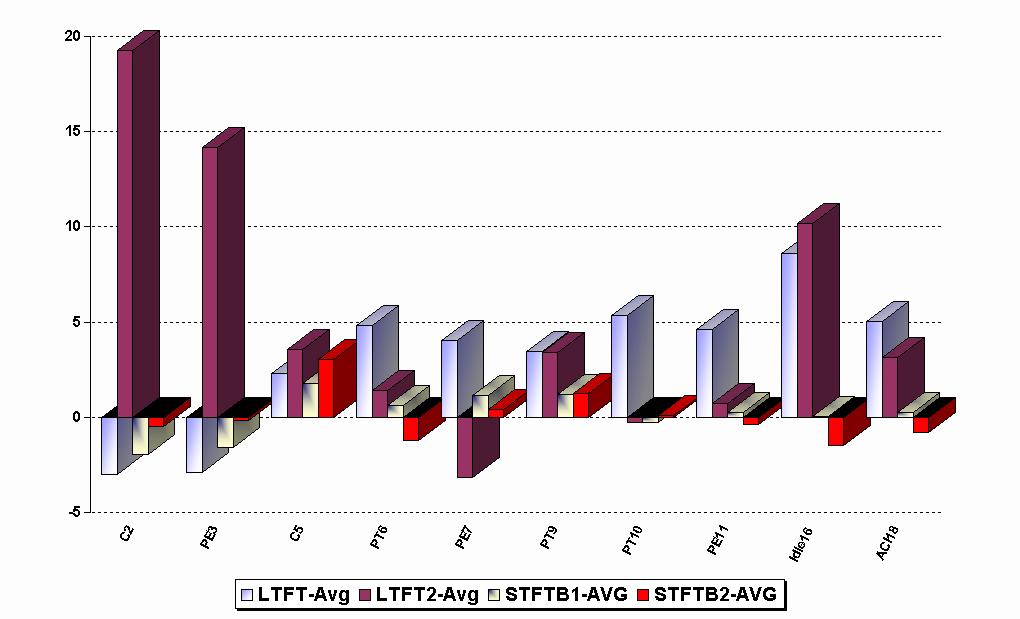

Owner did a 2nd scanner recording and problems still exist
I'd suggest they review and change their tuning methods
Fuel trims cells 2 and 3, decel too rich where other engine loads are too lean
