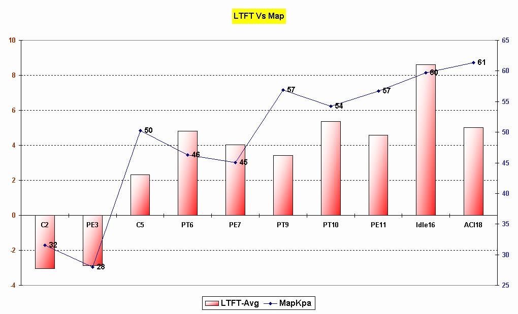

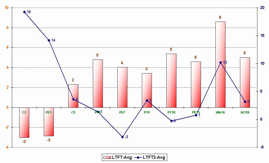

#1970 - 09/01/0710:00 PMTuning when problems exist
Joined: Dec 2000 Posts: 5,938teamzr1 Owner - Pays the bills
Posts: 5,938
This car is being tuned now but if scanner data is analyzed you notice there is a problem that must be corrected first as why left and right fuel trims are not equal
