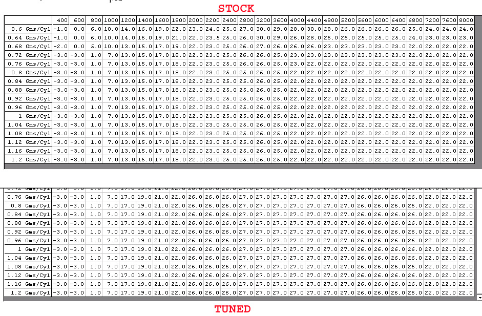

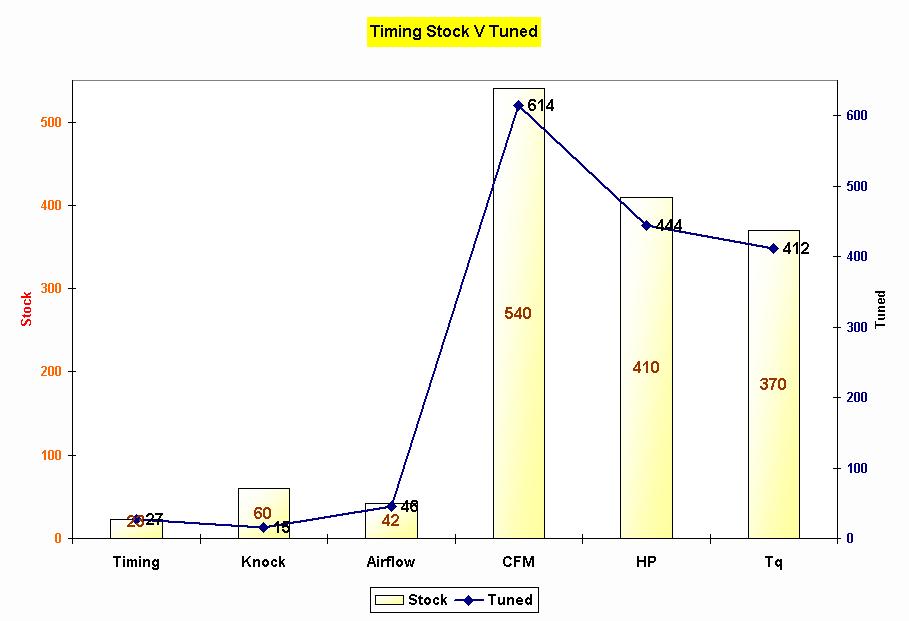

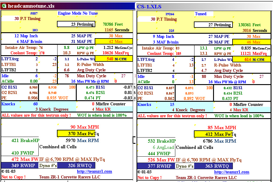

For this example we compare a stock GM calibration and one we tuned in a 2001 Z06.
Review that values and results below but at the least if the stock timing is only increased 4 degrees of timing with other functions properly tuned you see higher performance, engine taking in more air and still even less knock occuring.
So even if the engine is stock a custom tune will gain the performance and reduce issues such as knock and misfire so performance is not lost during those conditions
