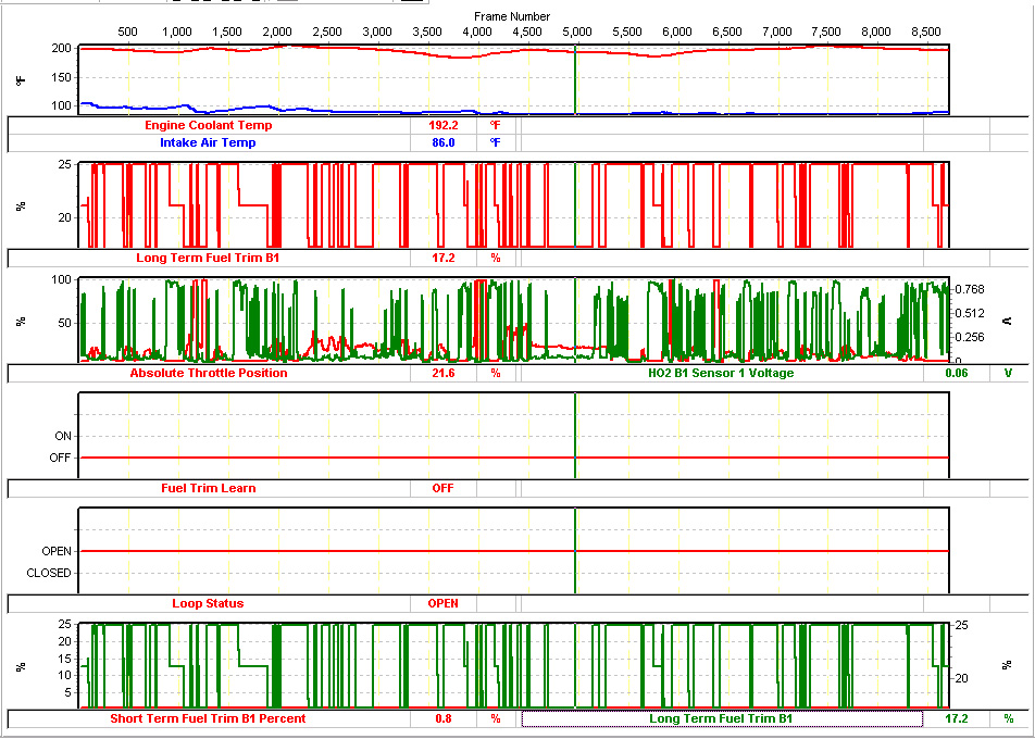

I had him do a drive with Ease scanner recordings and email it to me to analyze
You spot right off that engine stays in OPEN loop
Look at the sensors that dictate which loop, TPS, MAF, temps and MAP and they are good.
Stuck in OPEN loop and notice fuel learn stays OFF, fuel trims super lean and so are values from O2s. Bigger clue is short term fuel trims locked at zero.
Simple then to know what was wrong so I told them to measure fuel rail pressure and sure enough instead of being 58 PSI it was 24
