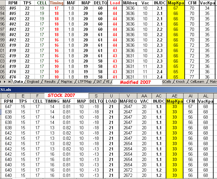

2. You know it is screwed when at idle the MAP is at 60-65 KPA.

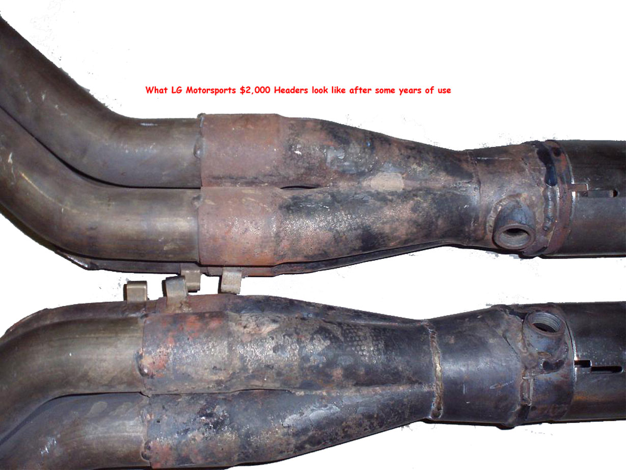

For 3 plus years now we have seen many vettes with LG mods, either ill designed headers, telling customers to yank smog parts out and way overpriced costs along with lousy PCM tuning so they belong in this forum section.

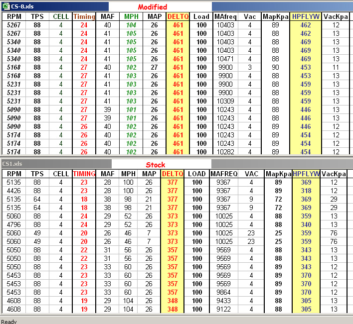

Here is results after all the clean up :

Here is a good example when the wrong selection of CAM grind
Stock 2007 C6 on the bottom of these collected scanner data traps.
Notice this modified 2007 ( top data stream) mentioned in this thread how much vaccum is lost at idle and thus a domino effect to all other engine functions.
Compare the functions and their values.
#2107 - 11/12/07 04:16 PM Re: LG Motorsports [Re: teamzr1]
Here is where mods make an effect and that is at upper engine loads.
The mods itself would be useless without a good custom tuning as you notice the modified 2007 C6 has higher timing due to the tune.
Notice the torque and horsepower flywheel levels

#2934 - 12/18/08 02:46 PM Re: LG Motorsports [Re: ]
Here is what the $2,000 LG headers look like over time
Also the bung for the O2 sensor weld is junk and leaking
Great high quality metal used puke
