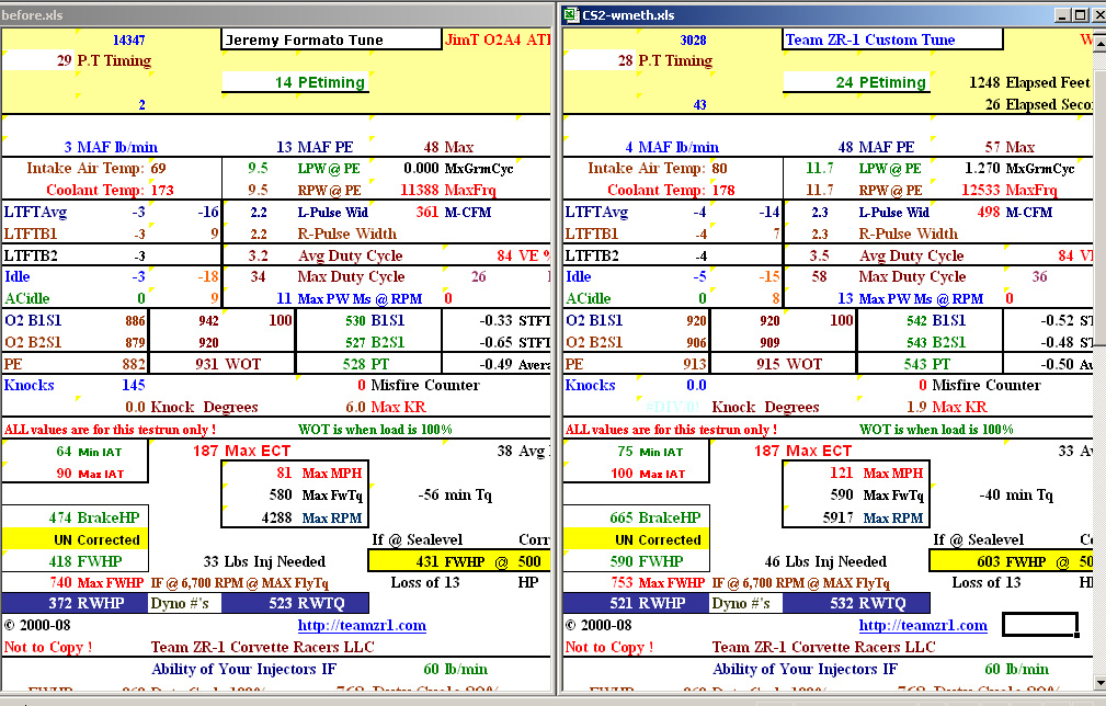

Customer comes to us for a total retune. He of course is 3,000 miles away in Flordia and has bought a tuner tool so we did this all via emails requiring them to do a testdrive with a scanner and email us the recording to analyze which we did and is the results on the left side of image below.

Closely look and the Before and After results, everything from WOT timing, to what the final horsepower and Torque values are to see for yourself that this JF - FastProms should NOT be tuning his own car much less the big bucks you have spent on your car.
