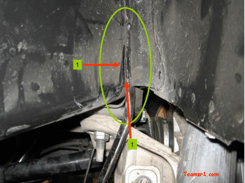

Remove the fuel tanks and inspect the frame on both the left and right side of the vehicle.
If a void is found, it will be necessary to re-weld this area.

Here is a snapshot of the area and shows the defect
