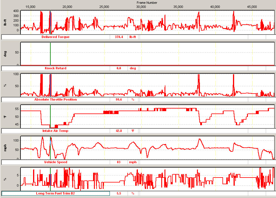

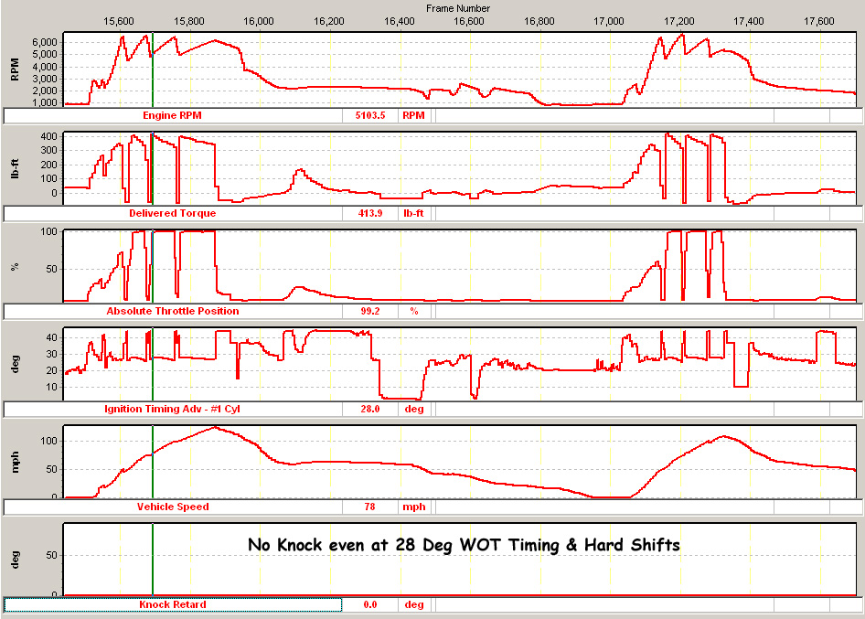

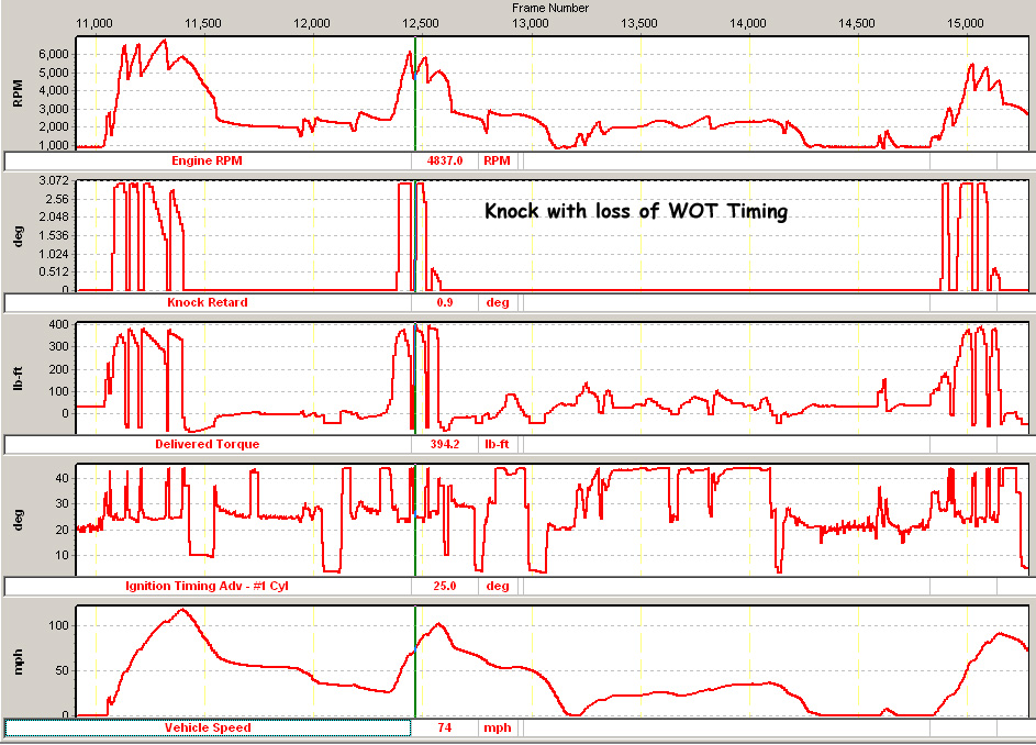

I spent some serious time doing different experiments with PCM tuning calibration and finally came up with a tuning method that got rid of all the real and mostly false knock.
End results below show how much knock this engine had when hard launching and shifting near rev limiter and then after our knock style tune was done with results of zero ping, increased torque and horsepower due to no reduced timing due to knock.

Day 3 of testing Weather only 20 degrees and the traction issues seen in results below. Be sure to look at the Throttle and RPMs to see what it took to get through the gears from a launch.
This test we leaned up the fuel trims even more and still got no knock

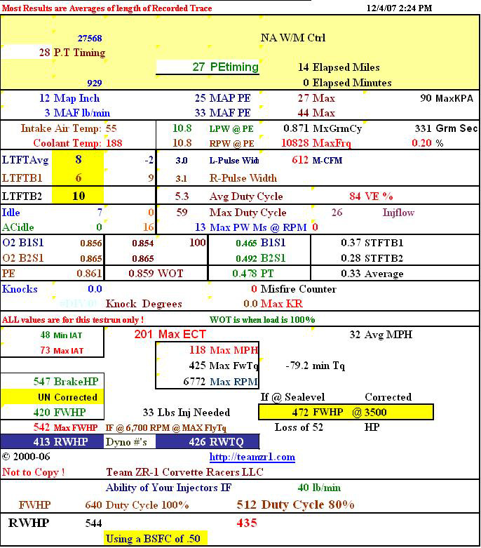

#2171 - 12/04/0701:39 PMRe: Killing of Engine Knock
[Re: teamzr1]
Further testing we on purpose set the fuel trims via tuning so that they were 8 percent lean on average.
As seen even being this lean there was no knock at all, the WOT timing at 27 degrees with engine compression at 11.3:1 with 91 octane smog gas.
This also points to the fact of the cyberspace myth that the fuel trims must be rich on average when all that really does is reduces gas mileage and less torque as the leaner AFR is the more torque is seen as we shown in these results.
Weather for this test was about 45 degrees.

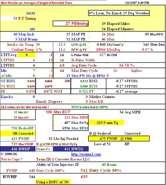

Last day of testing where fuel trims were set to an average 8% too lean.
Proven over these tests proved.
1. the Long term fuel trims do not need to be bias rich for part throttle as the cyberspace bullshit states to have good WOT conditions
2. Knock can be tuned out even when engine compression is 11.3:1 and using 91 octane gas.
3. WOT timing has to be 22 degrees or less proven also to be bullshit as seen here with this stroked LS1 with high compression runs best at 27 degree WOT timing.
4. The design of our water/meth smart controller even used in 35 degree weather not only handles lean issues but also preserves performance while increasing gas mileage as with our vette with a 3.73 rearend gear still got 17 MPG city and 29 MPH on highway using 40 lb/hr fuel injectors.

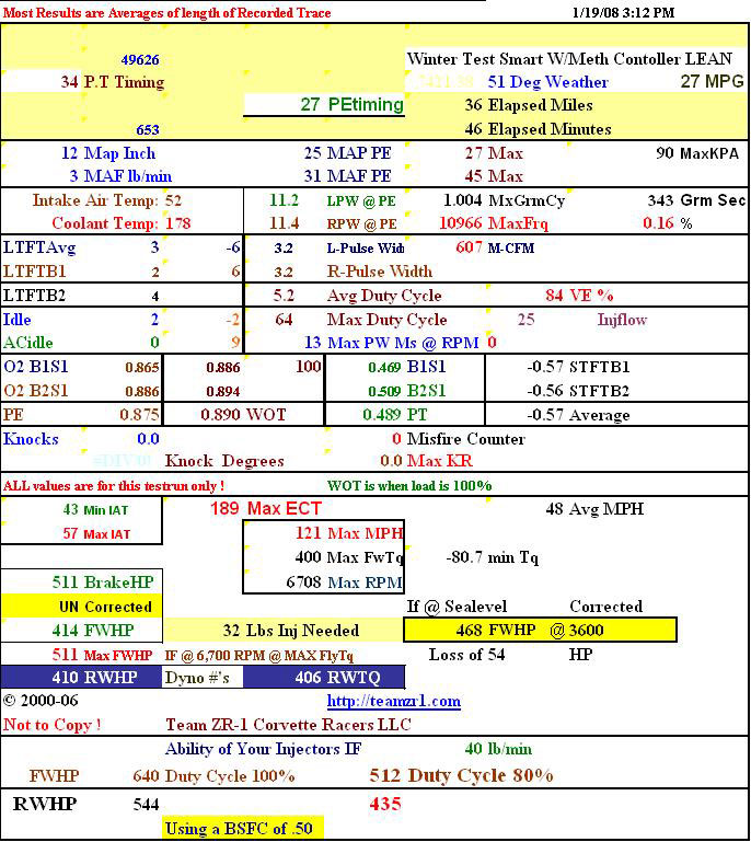

This testing was 30 days after last tests were done to see if over that period of time if anything changed in forcing the fuel leaner, esp during power enrichment and WOT.
Weather was between 45-50 degrees.
Due to that and all the cinders on the road city uses for ice on road I could not do hard standing start WOT launches so the maximum performance could be seen but enough hard engine load to see if any knock would occur or loss of timing due to it.
Maximum speed was 121 MPH Maximum RPM was rev limiter at 6,700 RPMs Maximum airflow was 45 lbs which shows engine was pulling very nicely Average WOT timing was 27 degrees which shows no loss due to being too lean.
Combined driving had a 27 MPG average.
Zero knock or misfire. Not even 1 degree of timing lost.
Even though flywheel HP was 468 the maximum injector cycle of these 40 lb injectors was only 64 percent while the maximum injector needed for this testrun was only 32 lb. Consider a stock LS1 uses a 26lb and that is for only 350 HP.
This shows :
1. again that the engine does NOT have to be tuned to be rich as in this case LTFTs were set as seen in the results that WOT engine loads fuel trim cells 15 and 22 were about 5% too lean yet no ill effect to engine or performance.
2. Using water/methanol correctly reduces the load on how long injectors are on, less fuel needed and engine can use a smaller injector that has better response times.
O2s reported for NON WOT at 489 mVolts which is about a AFR of 14.2:1 which is correct for smog gas and during WOT reported 875 mVolts which is about 12.5:1 AFR even though fuel trims going into WOT was 5% too lean.
