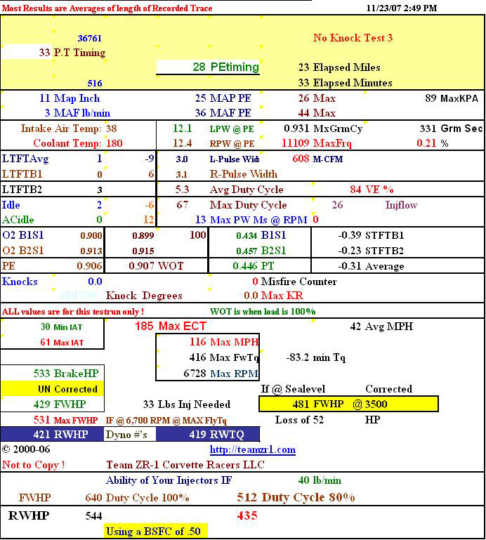

The engine in our 1999 is stroked, CAM, larger injectors and headers. The engine compression is 11.3:1 which only makes the fact 91 octane smaog gas can be gotten so knock has been a constant issue.
I spent some serious time doing different experiments with PCM tuning calibration and finally came up with a tuning method that got rid of all the real and mostly false knock.
End results below show how much knock this engine had when hard launching and shifting near rev limiter and then after our knock style tune was done with results of zero ping, increased torque and horsepower due to no reduced timing due to knock.

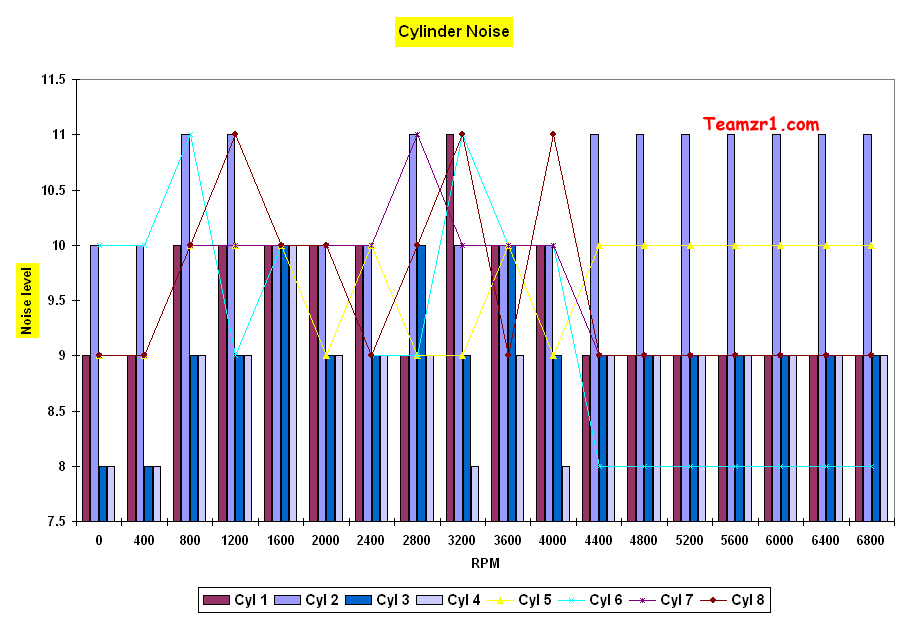

Here is how GM plotted and set noise levels for LS6 as base noise for knock per cylinder, IE noise not equal to each

#2143 - 11/20/07 06:54 PM Re: Killing of Engine Knock [Re: ]
I looked at your flash and other C6 model and years with LS2edit V2.0H and that base noise table is not there. You might contact carputing and find out why
I then looked at C6 with like hptuners and it shows a different table for each cylinder. Not sure if its even valid but that is what they show.

Day 3 of testing
Weather only 20 degrees and the traction issues seen in results below. Be sure to look at the Throttle and RPMs to see what it took to get through the gears from a launch.
This test we leaned up the fuel trims even more and still got no knock
