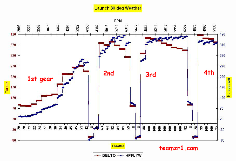

Day 3 of testing
Weather only 20 degrees and the traction issues seen in results below. Be sure to look at the Throttle and RPMs to see what it took to get through the gears from a launch.
This test we leaned up the fuel trims even more and still got no knock

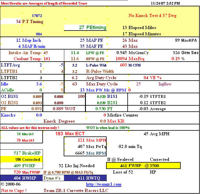

Day 4 of testing, this time we leaned up PE and WOT fuel and still have good results with 27 deg WOT timing and zero knock.
Weather 34 deg, still allowing water/meth to be functional though it would have no bearing on cooling air temp at this cold of weather but would have had ill effect to knock with stock GM calibration.

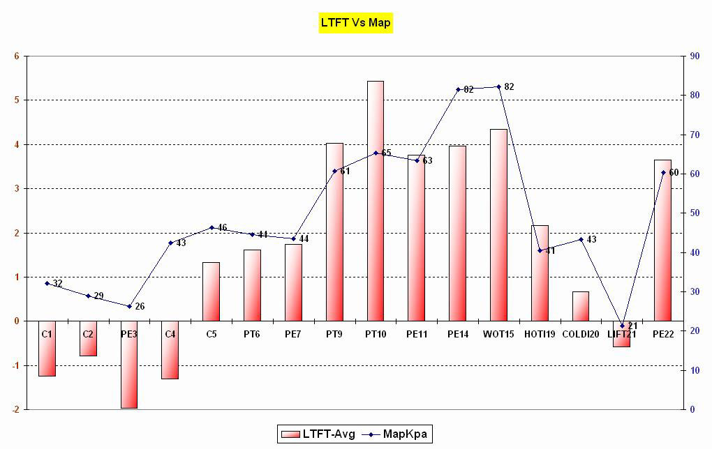

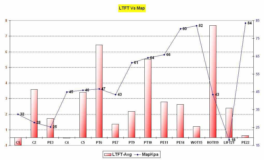

Further testing we on purpose set the fuel trims via tuning so that they were 8 percent lean on average.
As seen even being this lean there was no knock at all, the WOT timing at 27 degrees with engine compression at 11.3:1 with 91 octane smog gas.
This also points to the fact of the cyberspace myth that the fuel trims must be rich on average when all that really does is reduces gas mileage and less torque as the leaner AFR is the more torque is seen as we shown in these results.
Weather for this test was about 45 degrees.

Last day of testing where fuel trims were set to an average 8% too lean.
Proven over these tests proved.
1. the Long term fuel trims do not need to be bias rich for part throttle as the cyberspace bullshit states to have good WOT conditions
2. Knock can be tuned out even when engine compression is 11.3:1 and using 91 octane gas.
3. WOT timing has to be 22 degrees or less proven also to be bullshit as seen here with this stroked LS1 with high compression runs best at 27 degree WOT timing.
4. The design of our water/meth smart controller even used in 35 degree weather not only handles lean issues but also preserves performance while increasing gas mileage as with our vette with a 3.73 rearend gear still got 17 MPG city and 29 MPH on highway using 40 lb/hr fuel injectors.
