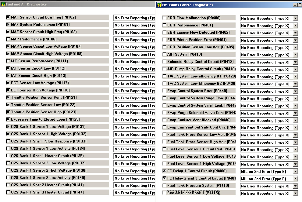

Another of the worst I have seen for custom tuning
In this case a LS1 with a A4 trannie was installed in a old Chevy Nova.
Owner has had vendor Vinci custom tune this several times
Engine does not run right and the trannie does not work when manually shifting will not change gears.
One thing totally not acceptable is you notice they turned off about every DTC error code to hide issues so that owner never knows when a problem occurs puke
As seen they unckecked the DTCs and told it not to report any of the errors making it blind to any use of a OBD-II scanner
More to come as I take this apart and fix all the problems
Shown is just a small amount of DTCs turned off.
