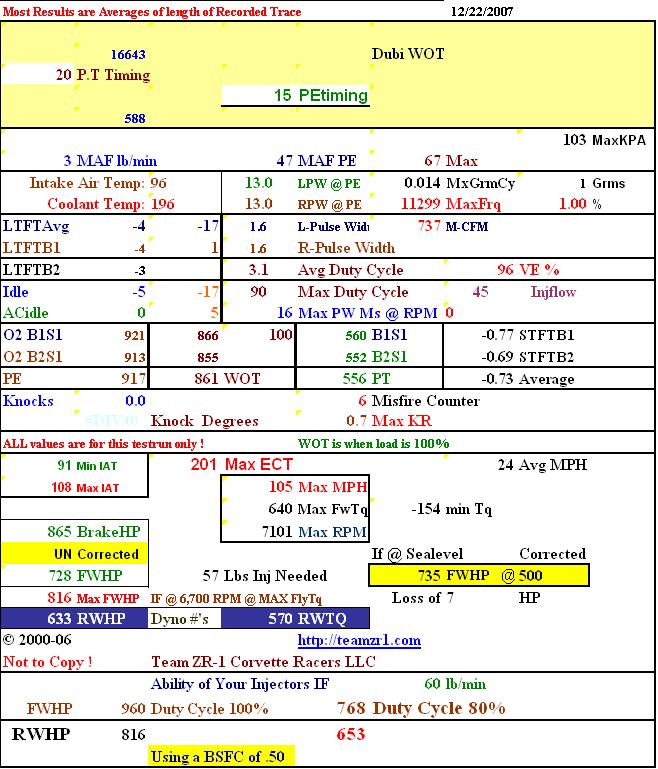

We are in the process of cleaning this up
Customer had someone else tune for this stock LS7 with ATI supercharger with 60 lb fuel injectors and engine ran very poorly.
Here is what the numbers looks like after the 1st cut of our custom tune
