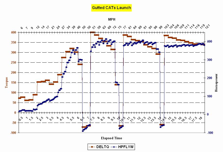

Here is a compare of launching to 120 MPH with the G (gutted CATS)
Then with the proper placement of our X-pipe
And then a superimposed scanner data of both as to HP and Tq.
You notice with the front placed X-pipe HP and Tq come on much faster and have aboust 3 MPH faster then G-Cats at the same distance
