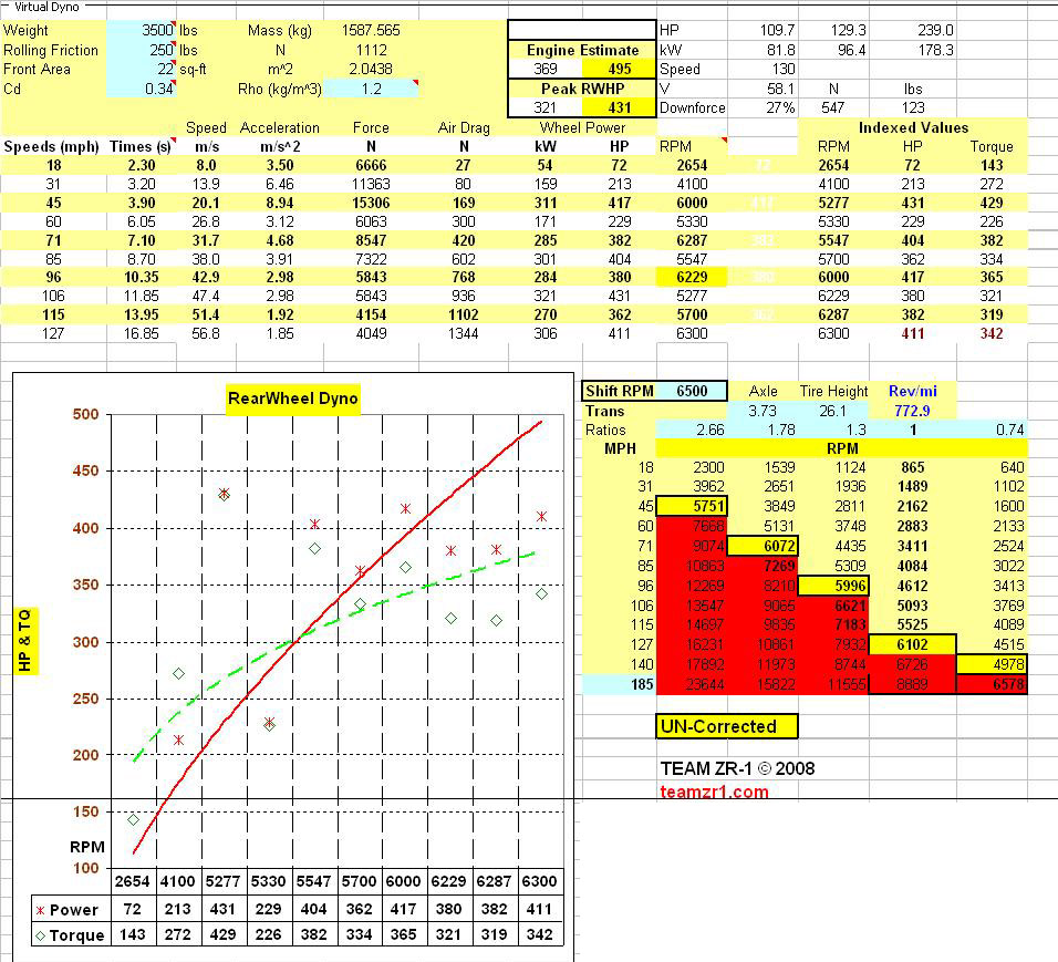

Rearwheel dyno numbers

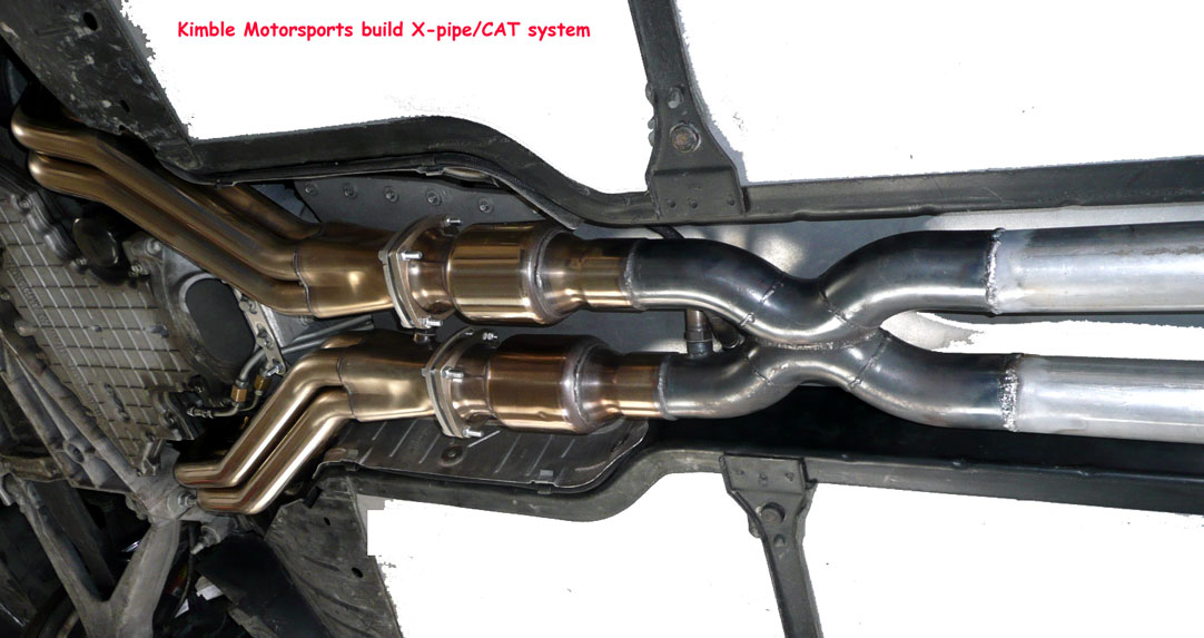

Here is how Richard from Kimble Motorsports build a combined X-pipe and high flow CATs system for Bob R's C5

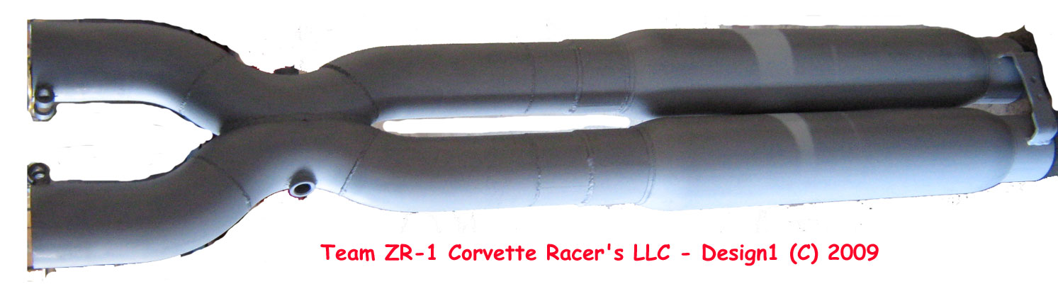

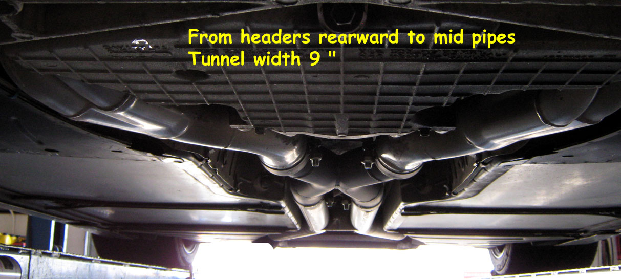

More images of X-pipe testing

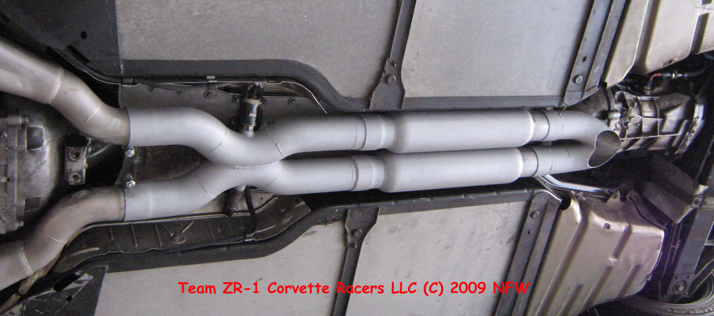

First design has the exhaust from the long tube header collectors 46 total inches to the muffler tips.
As image shows the mufflers take up 24 inches of that length.
Weight of stock exhaust with no cats was 65 pounds, total designed system is only 23 pounds.
In testing the sound as to DbC level is too high,
average inside of car with windows up is about 110 DB and as much as 128 DbC near the rear wheels.
Measuring as to ear quality levels as DbA inside measured 92 and outside 102 DbA.
We want final design under 95 DbA and less then 85 DbA inside.

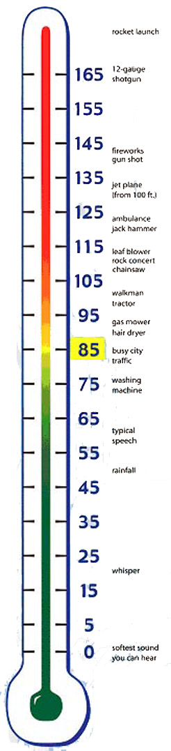

Sound pressure is measured in decibels (dB). Like a temperature scale, the decibel scale goes below zero. The average person can hear sounds down to about 0 dB, the level of rustling leaves. Some people with very good hearing can hear sounds down to -15 dB.
If a sound reaches 85 dB or stronger, it can cause permanent damage to your hearing. The amount of time you listen to a sound affects how much damage it will cause. The quieter the sound, the longer you can listen to it safely.
If the sound is very quiet, it will not cause damage even if you listen to it for a very long time; however, exposure to some common sounds can cause permanent damage.
With extended exposure, noises that reach a decibel level of 85 can cause permanent damage to the hair cells in the inner ear, leading to hearing loss. Many common sounds may be louder than you think…

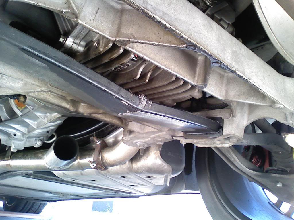

Not a smart thing to do as this owner put in cutouts that is forcing all the time hot exhaust over time delaminates the fiberglass spring, causing failure of spring and also adds more heat to the transaxle that already gets too hot

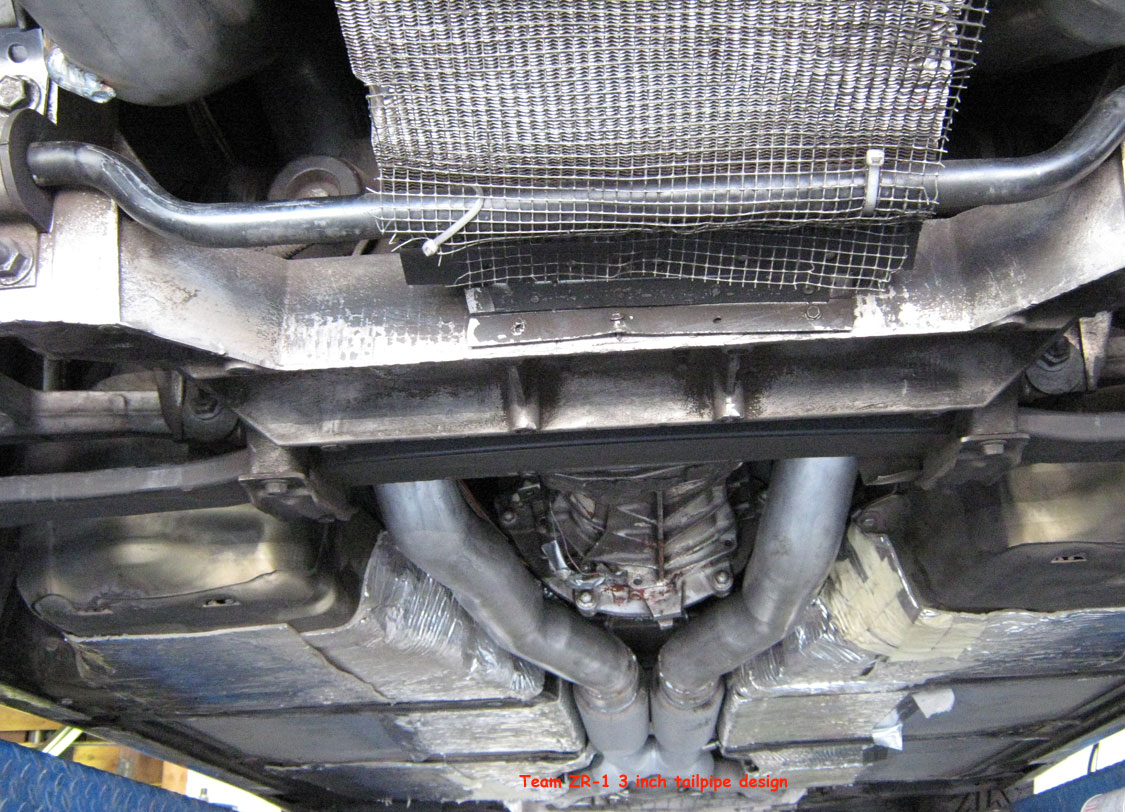

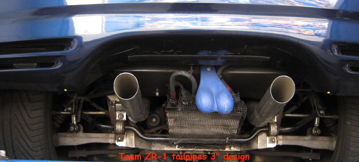

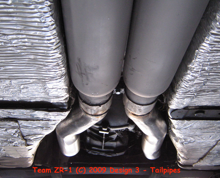

Third round of NFW exhaust design has been completed.
We wanted a balance so that for those that wanted less DBA inside the car but not lose the sound or increase backpressure at the exhaust tips they could now choose to their liking by either using design stage two or :
We designed 3 inch tailpipes from our custom designed mufflers to ending out the back end.
Testing showed the DBA inside the car now running between 80 and 88 DBA with only a 2 DBA drop at the end of tailpipes.
There is a 2 DBA difference inside the car depending on if the windows are open or closed.
This allows those that buy our NFW system to choose the race ( higher DBA) and later could purchase our tailpipes of buy the total system and install or take off the tailpipes when need be
Attached is some audio recordings from part throttle to WOT, with recordings captured inside and with the mic mounted by license plates.
You will need to unzip the files to listen to the recordings.
WOT.zip (271 downloads)
Partt.zip (279 downloads)

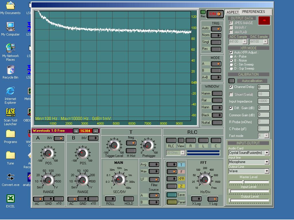

Scope sound levels at part throttle
