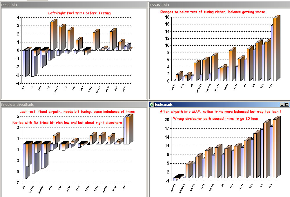

In the testcases below simply changing how the air gets to the MAF not only highly effected the fuel trims going way too lean but also tricks PCM into thinking one side of the engine is leaner then the other side.
Notice that just a simple change of a crappy CAI design causes the PCM to THINK fuel trims are as much as 15% leaner then with a correct CAI design when in fact the grms/cyl report the same and so does the MAF in frequency and lbs/min
Even forcing injectors via a tune to go 10% richer made no difference as to reporting false lean conditions. Odd is how the air enters the MAF fools PCM into thinking one side of engine is leaner then other side as seen in the results.
With the MAF mounted to the aircleaner there is no distance or way for bad airpath to smooth and straighten air as it passes over the exposed sensors in the MAF's airstream.
