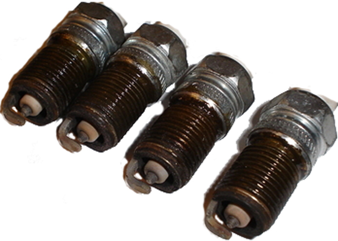

All the spark plugs look fine, look the same and have the same gap as I set them 34'000 miles ago (see the picture).
Nothing really explains the increased fuel consumption or the lazy engine feeling.
I replaced the spark plugs, just to be on the safe side.

[Linked Image]

The plugs in the image do seem to have lots of oil on the threads

oil on the threads... actually it's copper grease.
on the picture it shines as it was liquid, but it's grease.
