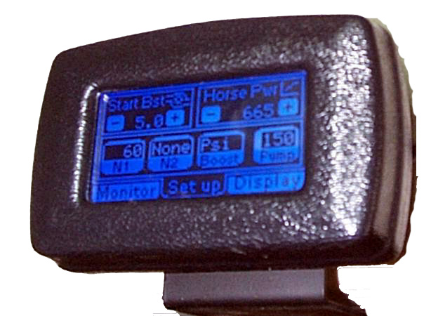

#2010 - 10/08/07 01:19 PM Team ZR-1 Smart water/meth controller with Touch Screen
Team ZR-1 has just released the first of it's kind, a automatic adjusting, smart controller that has a touch screen to allow you to make realtime adjustments and to monitor how your water/methanol injection system is functioning including informing you of the duty cycle of the fuel injections, amount of injection flow and PSI of the boost from supercharger, turbo or N20

This even allowing changing the nozzle size of the w/meth and our controller senses that and auto adjusts volume flow.

This is a great set-up. smile I have a few questions:
- Can you read the screen in the daylight?
- I still need to buy a pump and tank, correct?
#2062 - 10/31/07 06:15 AM Re: Team ZR-1 Smart water/meth controller with Touch Screen [Re: ]
Yes the screen can be seen in daylight like you would a GPS but I'd mount it so that the sun is not always directly on it.
You could buy the rest of the water/meth injection from us.

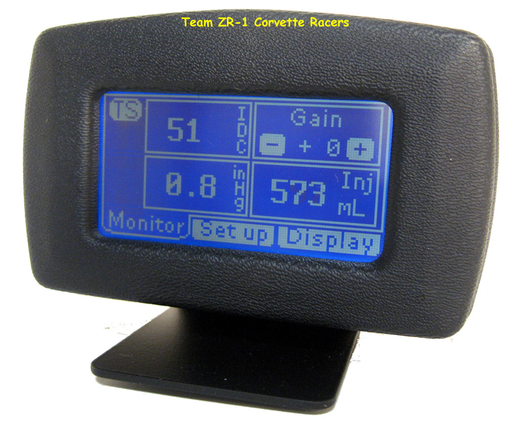

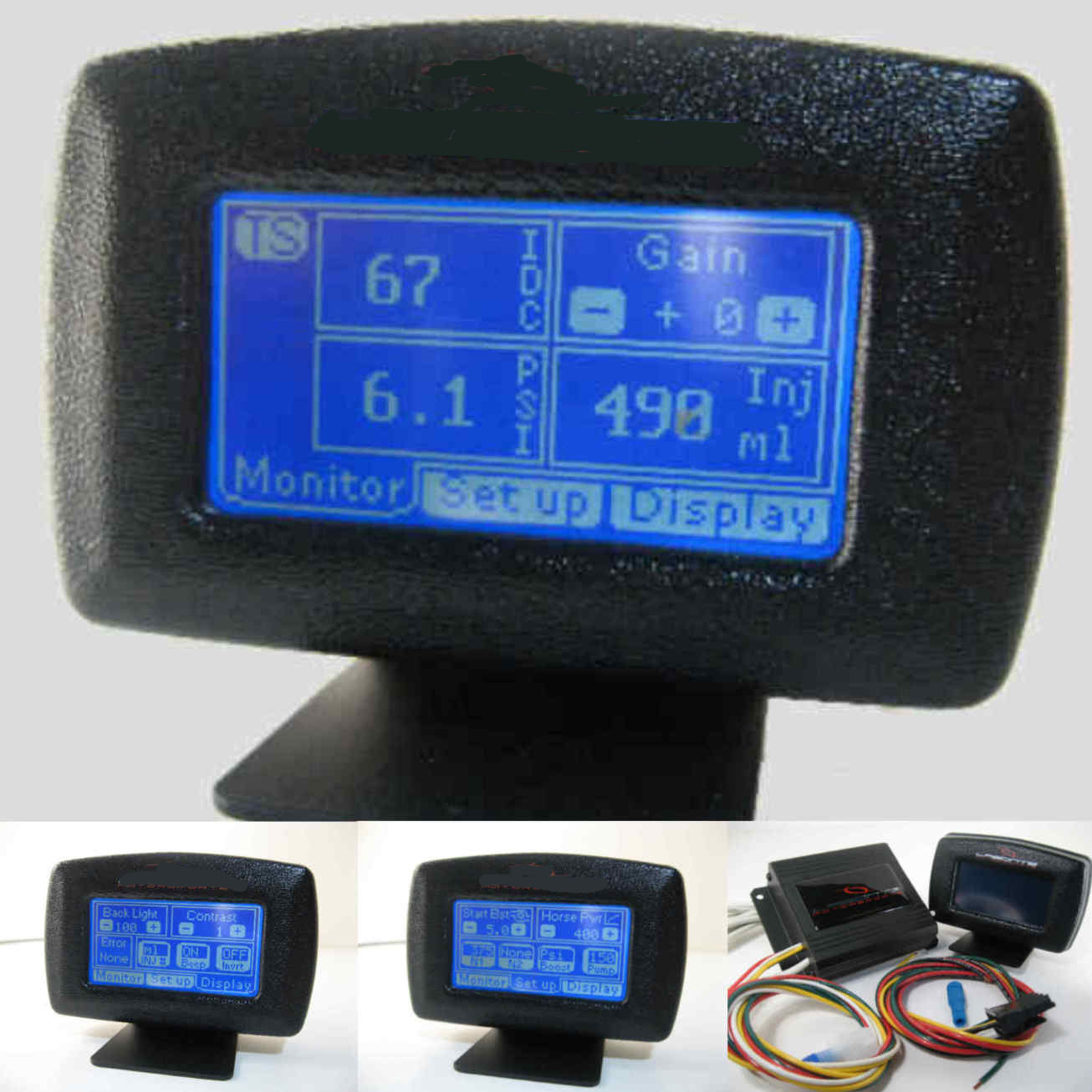

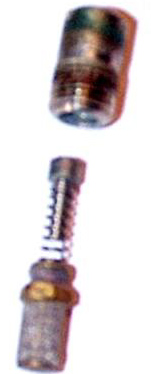

Here is a better quality image of our 3D water/methanol touchscreen to controller.
Has 3 screen pages can switch by the tabs at the bottom

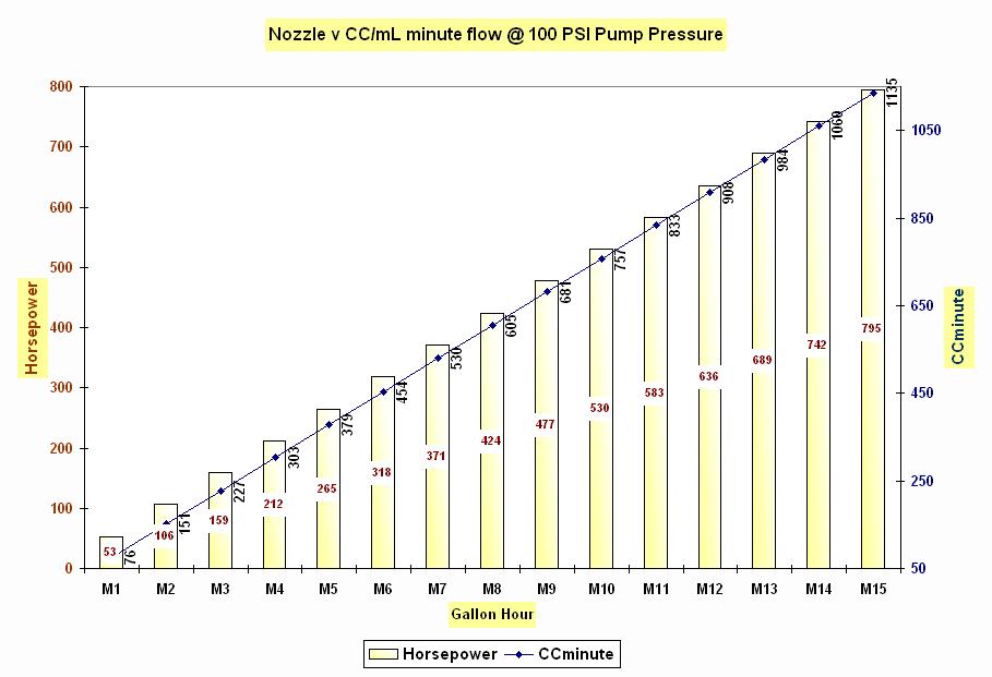

Aprox fluid flow through Nozzle when pump is at 100 PSI
#2510 - 04/20/08 09:41 AM Re: Team ZR-1 Smart water/meth controller with Touch Screen [Re: teamzr1]
Flow rates per different pump PSI
Injector Flow Rates:
M1  -  (.011")  -  1.0 GPH @ 100 PSI, 1.2 GPH @ 150 PSI, 63 CC/min @ 100 PSI, 76 CC/min @ 150 PSI
M2  -  (.015")  -  2.0 GPH @ 100 PSI, 2.4 GPH @ 150 PSI, 126 CC/min @ 100 PSI, 151 CC/min @ 150 PSI
M3  -  (.020")  -  3.0 GPH @ 100 PSI, 3.6 GPH @ 150 PSI, 189 CC/min @ 100 PSI, 227 CC/min @ 150 PSI
M4  -  (.024")  -  4.0 GPH @ 100 PSI, 4.8 GPH @ 150 PSI, 252 CC/min @ 100 PSI, 303 CC/min @ 150 PSI
M5  -  (.035")  -  5.0 GPH @ 100 PSI, 6.0 GPH @ 150 PSI, 316 CC/min @ 100 PSI, 379 CC/min @ 150 PSI
M7  -  (.045")  -  7.0 GPH @ 100 PSI, 8.4 GPH @ 150 PSI, 442 CC/min @ 100 PSI, 530 CC/min @ 150 PSI
M11 - (.073")  -  11 GPH @ 100 PSI, 13.2 GPH @ 150 PSI, 694 CC/min @ 100 PSI, 833 CC/min @ 150 PSI

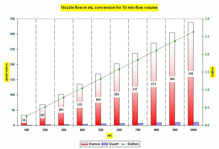

Conversion of fluids in mL to ounces, quart and gallon from 1 minute to 60 mountes ON time
