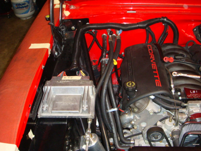

This owner doing a hotrod Nova decided to go with LS6 powertrain and trannie.
The shop working on the car used a 2002 Camaro PCM that we custom tuned to make it all work along with tuning the A4 trannie.

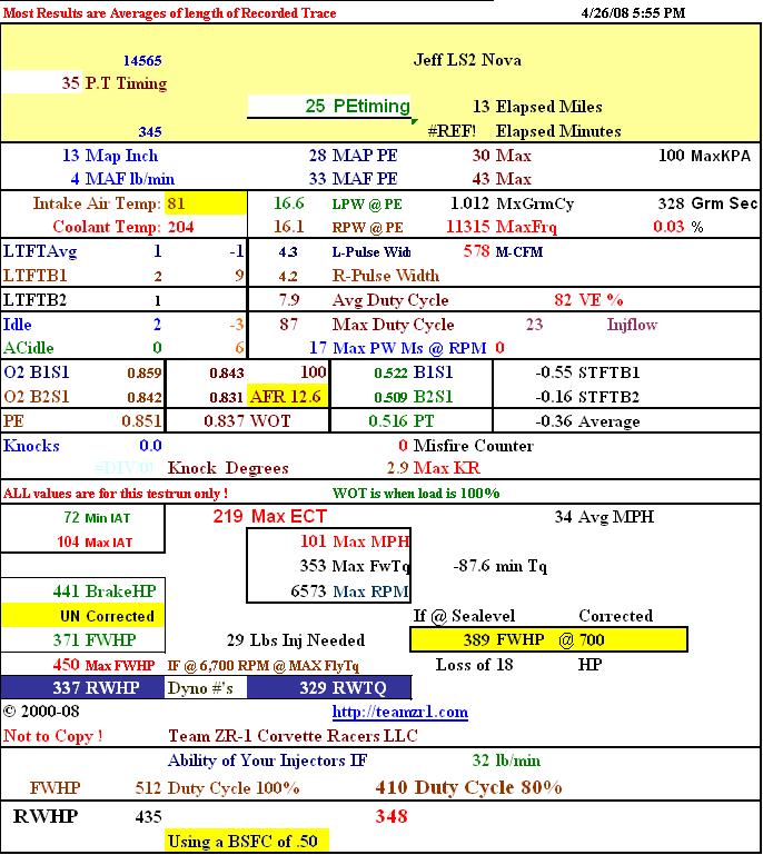

Update, car was finished but 2 months later owner decided he wanted to swap the LS6 to a LS2.
Shop finished doing that swap and we did the base tune this weekend and all seems to be OK except the owner wants to make tuning changes as how the A4 trannie shifts.
Here is the results from base tune, we'll tweak once engine is broken in and A4 is adjusted
