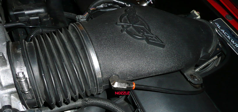

Here is how Bob R in Idaho had our 3D smart water/meth system with touch screen control installed on his C5.
I finally got my water/meth system installed thanks to Rich and Kimble Motorsports. They did a very clean stealthily install.

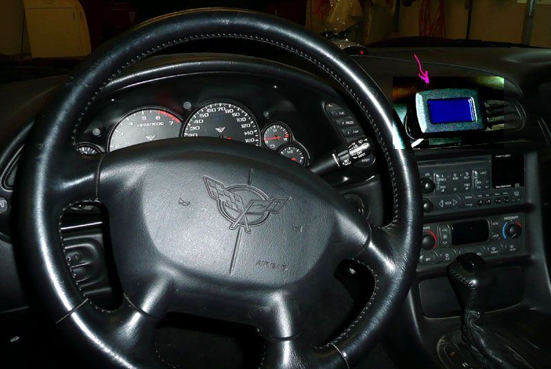

Pictures attached show the Smart controller in the center vents with can be removed and disconnected if needed.

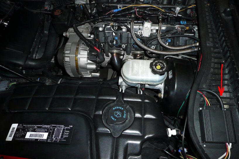

The main controller is mounted on the plastic flashing by the wipers out of the heat of the engine bay.
I am using the stock windshield wiper tank for my water/meth reservoir and it still is functional for wiper fluid, but I never use that anyway.

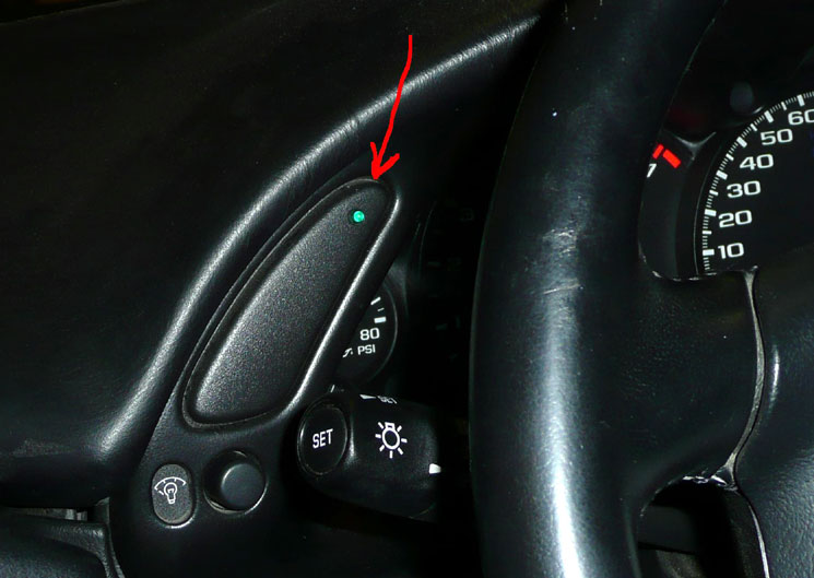

The green "spray-is-on" LED is in the dash on left side of steering wheel and you can't see it unless it is on (+3400 RPM).
