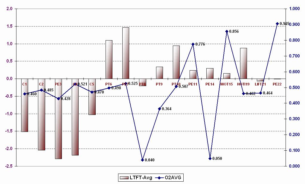

This shows what the front 02 sensors reported verus what LTFT values for each fuel trim cell that was used

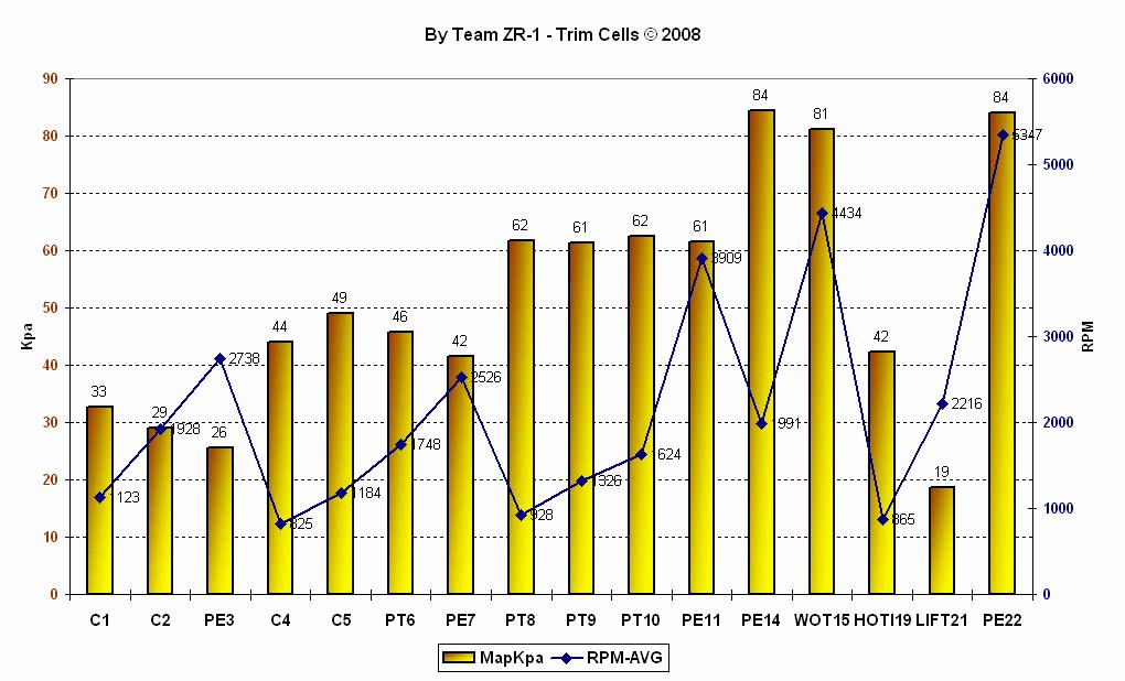

Each fuel trim cells, over MAP and engine RPMs
