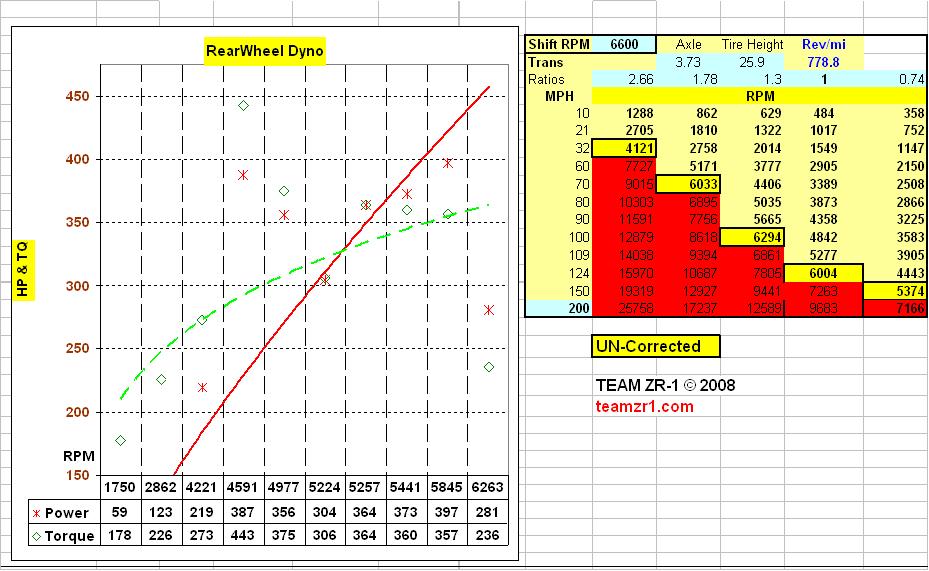

#2588 - 05/21/08 10:39 AM Re: Getting the most from using a OBD scanner [Re: teamzr1]
If wanting to gain the most information from that same scanner data we can plot the HP, Tq and speed per gear
