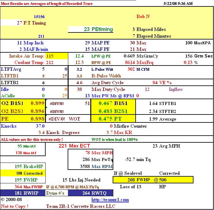

We had owner do a slow speed testrun with a Ease OBD-II scanner recording and then he emailed that to us to analyze
When we saw the following we then knew what the problem and fix would be

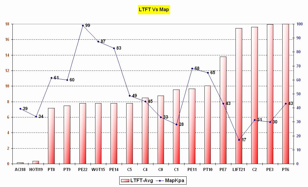

The fuel trims on average was 5% lean but this also was done in 90 degree weather.

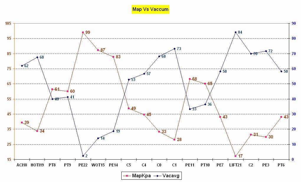

You notice though when looking at each fuel trim cell which were much leaner. What you see is cell 21 (decel) and the cells to the right of it are quite lean yet the MAP and vaccum show butterfly of throttlebody is closed so little air would be reaching engine to be that lean and thus air turbulance was the problem
Fix was simply in having the owner reduce the height of the cut in shroud so that the cut was low and then only 2 inches tall. This prevented swirling air going right to the MAF and also the colder air to enter the air cleaner
