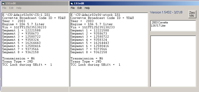

Does this mean if I changed the fan setting to come on at a lower temp and put in a 180 deg TStat, it will show up on the CVN's being different?

C5s are much safer, GM would not even bother, they would for a C6 though but in most cases for a C5 if done correctly you cannot tell the dfference as the example I did below is showing a untouched 02 Z06 and then when I made tuning changes and as you see the segment ID and CVN/broadcast are the same thus even comparing side by side you cannot tell which one I tuned
