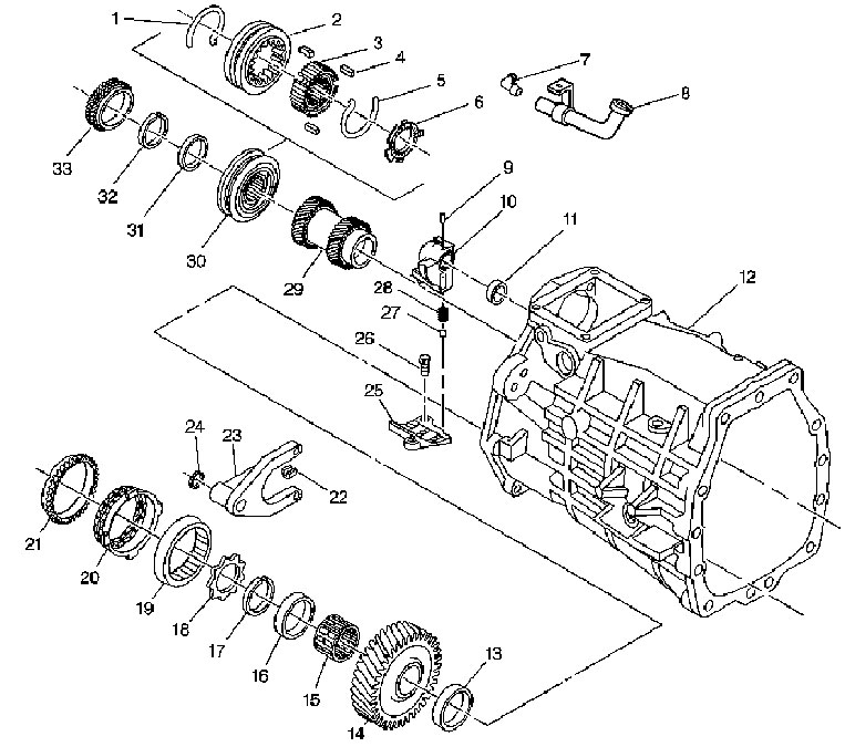

#2624 - 06/17/08 11:20 AM MN6 parts view
Posts: 6,046
Posts: 6,046
1) Reverse Synchronizer Spring
(2) Reverse Synchronizer Sleeve
(3) Reverse Synchronizer Hub
(4) Reverse Synchronizer Key
(5) Reverse Synchronizer Spring
(6) Reverse Synchronizer Key Retainer
(7) Vent
(8) Vent Pipe
(9) Offset Lever Roll Pin
(10) Offset Shift Lever
(11) Top Shift Shaft Bushing
(12) Transmission Case
(13) 6th Speed Drive Gear Bearing Spacer
(14) 6th Speed Drive Gear
(15) 6th Speed Drive Gear Needle Bearing
(16) 6th Speed Drive Gear Bearing Spacer
(17) Synchronizer Retainer Ring
(18) 6th Speed Drive Gear Thrust Washer
(19) 6th Speed Drive Gear Inner Cone
(20) 6th Speed Drive Gear Friction Cone
(21) 6th Speed Drive Gear Synchronizer Blocking Ring
(22) Reverse Shift Fork Pad
(23) Reverse Shift Fork
(24) Reverse Shift Fork Retainer Ring
(25) Guide Plate
(26) Guide Plate Bolt
(27) Shift Detent Ball
(28) Shift Detent Ball Spring
(29) 5th and 6th Speed Driven Gear
(30) Reverse Synchronizer Hub and Sleeve
(31) Reverse Gear Thrust Washer
(32) Reverse Synchronizer Retainer Ring
(33) Reverse Synchronizer Blocking Ring
