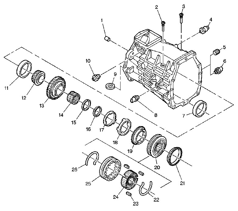

#2625 - 06/17/08 11:25 AM Re: MN6 parts view [Re: teamzr1]
Posts: 6,007
Posts: 6,007
(1) Case Rear Extension Pin
(2) 5th/6th Lever Guide Bolt
(3) Interlock Guide Bolt
(4) Computer Aided Gear Select Solenoid
(5) Oil Fill Plug (MM6 Only)
(6) Temperature Switch (M12 Only)
(7) Countershaft Bearing Race
(8) Backup Lamp Switch
(9) Magnet
(10) Shift Detent Assembly
(11) Mainshaft Rear Bearing Race
(12) Mainshaft Rear Bearing
(13) 1st Speed Drive Gear
(14) 1st Speed Drive Gear Needle Bearing
(15) 1st Speed Drive Gear Bearing Spacer
(16) Synchronizer Retainer Ring
(17) 1st Speed Drive Gear Inner Cone
(18) 1st Speed Drive Gear Friction Cone
(19) 1st Gear Synchronizer Blocking Ring
(20) 1st/2nd Synchronizer Assembly
(21) 2nd Gear Synchronizer Blocking Ring
(22) 1st/2nd Synchronizer Spring
(23) 1st/2nd Synchronizer Key
(24) 1st/2nd Synchronizer Hub
(25) 1st/2nd Synchronizer Sleeve
(26) 1st/2nd Synchronizer Spring
