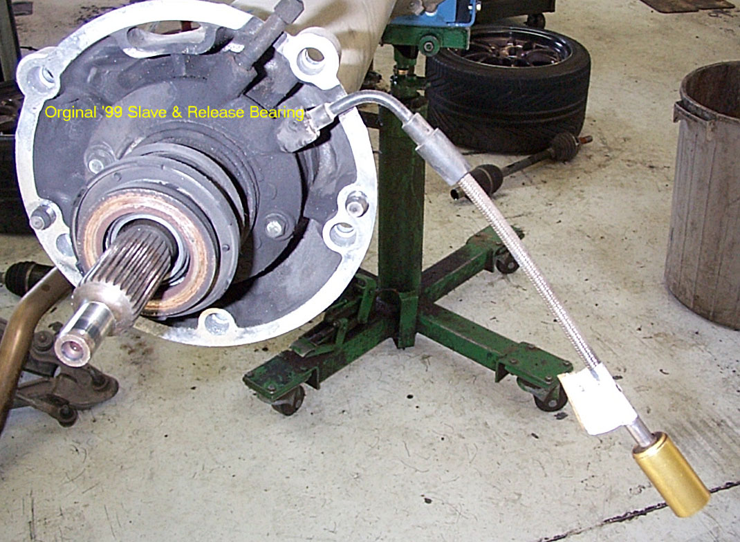

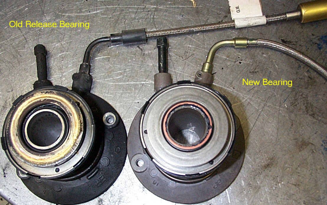

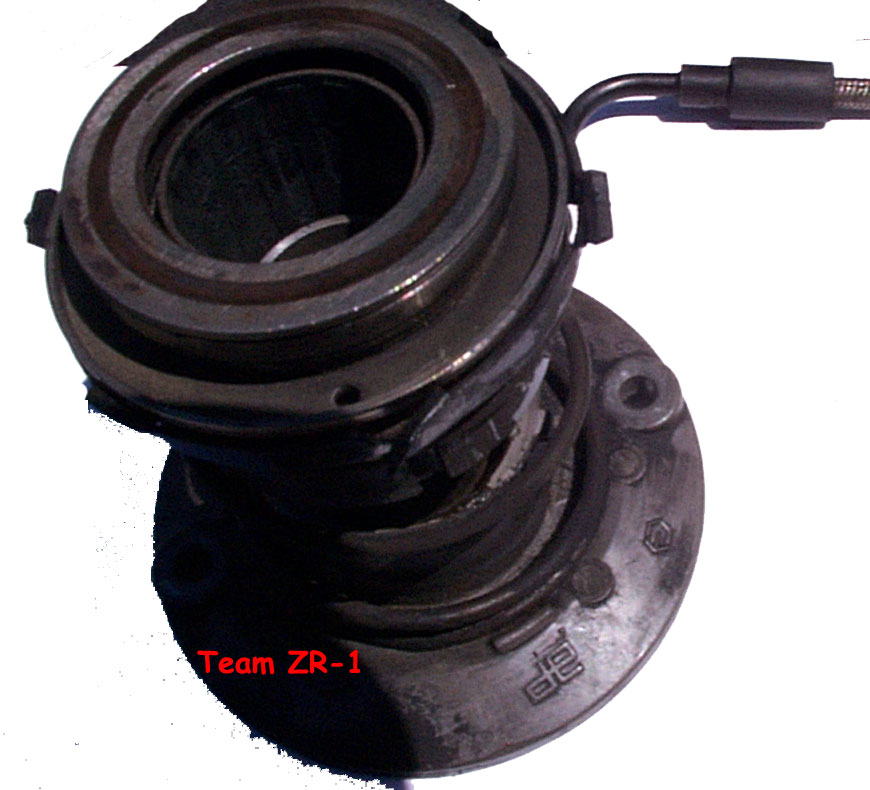

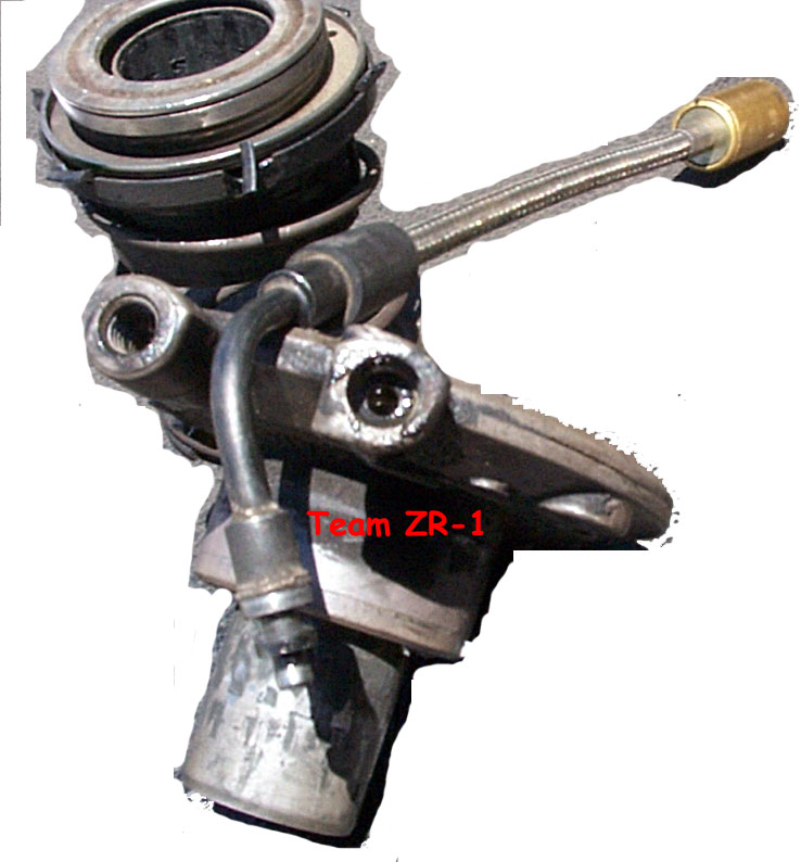

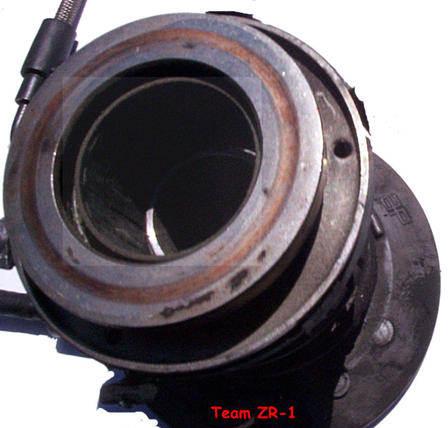

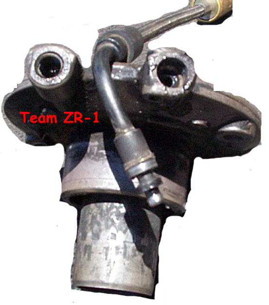

So all the below is on the slave that has been in out 1999 C5 for 7 years.
Compounding the whole problem is
1. slave design, as seen you can see all the packing (grease) that was in bearing gets heated and pushed out of bearing causing bearing then to have slop movement and the packing to gum up the shaft bearing slides onto.
2. the bearing female shaft slides over the male shaft of base of slave.
3. if you look closely you see flat grooves inside of bearing shaft, there is too much free play and with the packing grease gumming up the make shaft the groove of bearing wear grooves into the male shaft and due to all the slop freeplay the bearing gets cocked and jammed onto male shaft.
4. Notice the heavy wear marks on male shaft, it is easy then for bearing to get coked on an angle and rather then slide back down shaft is jammed, metal to metal.
5. Hose from clutch pedal, notice that even after 7 years with a ton of racing that the fitting at end of hose going into slave is still clean and the hole inside of slave to clutch hose is also clean, no dirt at all.
Add centrifugal force, due to GM making a weak design so those who otherwise could not drive a clutched Corvette could.
At certain high RPMs and due to centrifugal force the arms of pressure plate have less force and with a cocked throwout bearing cannot push bearing back which then would push the fluid back to allow clutch pedal to return to its upper limit.
Once you clearly see how the inside of bearing has lost the bearing packing, how it grooves the slave shaft and the packing grease gumming up and due to freeplay it is easy to see how bearing could get jammed and not return to proper position and dirty brake fluid in no way could cause any of this.

#2627 - 06/18/08 11:47 AM Re: Brake fluid cause of jammed clutch debunked [Re: teamzr1]
More images of slave/bearing

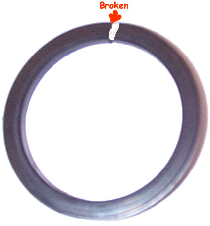

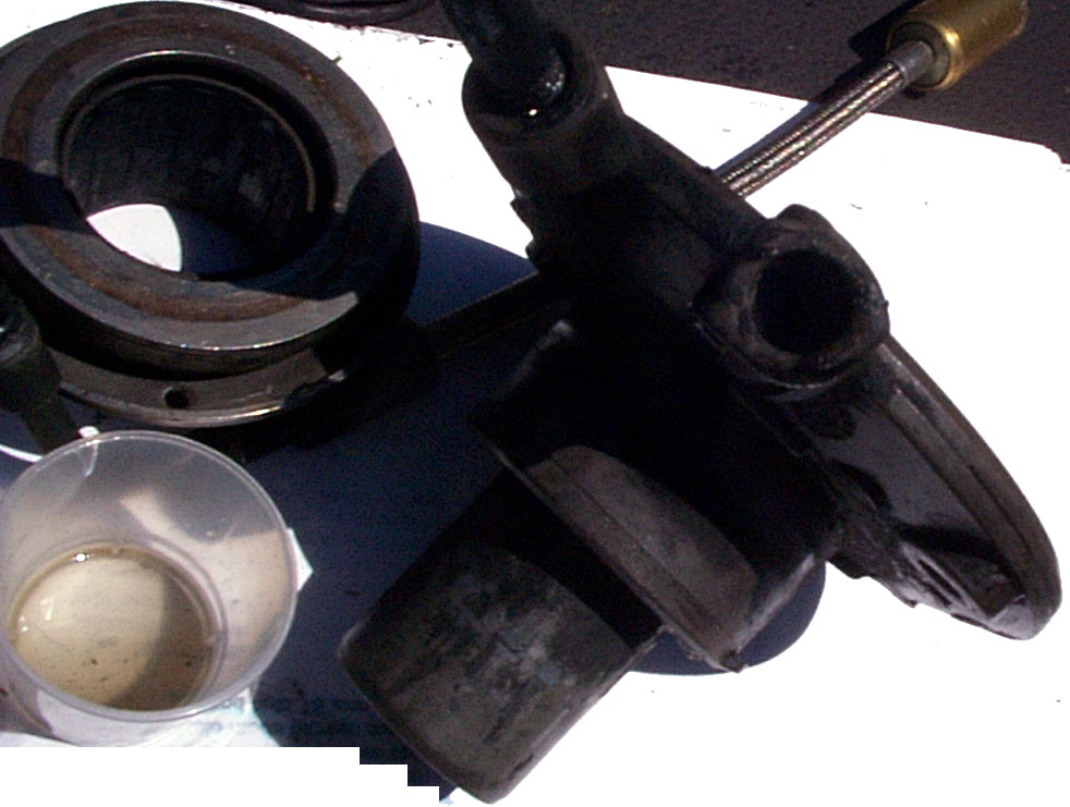

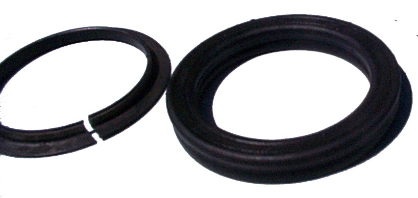

#2628 - 06/18/08 12:50 PM Re: Brake fluid cause of jammed clutch debunked [Re: teamzr1]
Here is the plunger seal that brake fluid would be covering and we see after all these years and being fluid had never been replaced is still clean. If fluid as being said was dirty and clogging system then seal also would be dirty.
Also look like due to force, metal ring that sits on top of seal had snapped

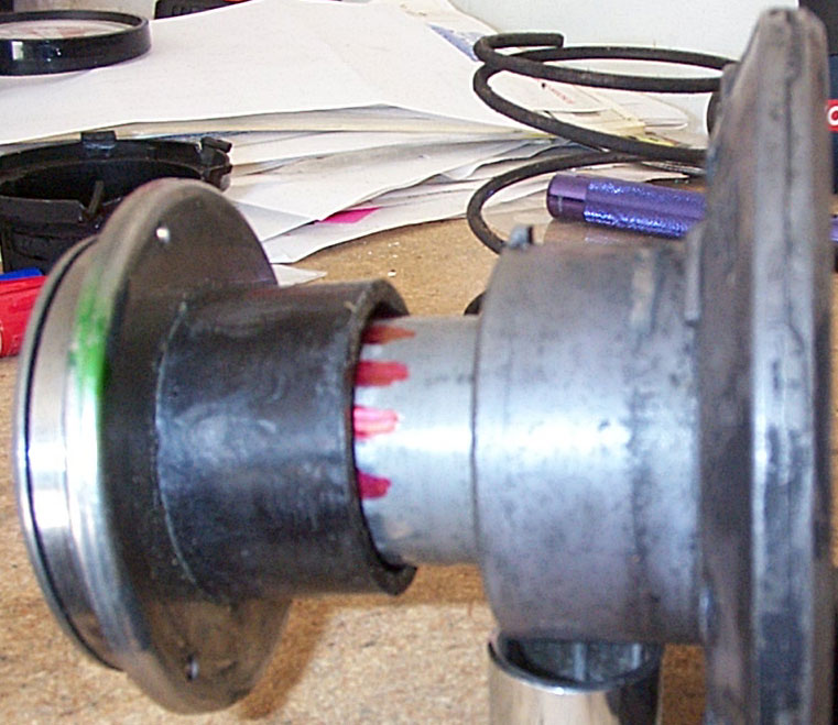

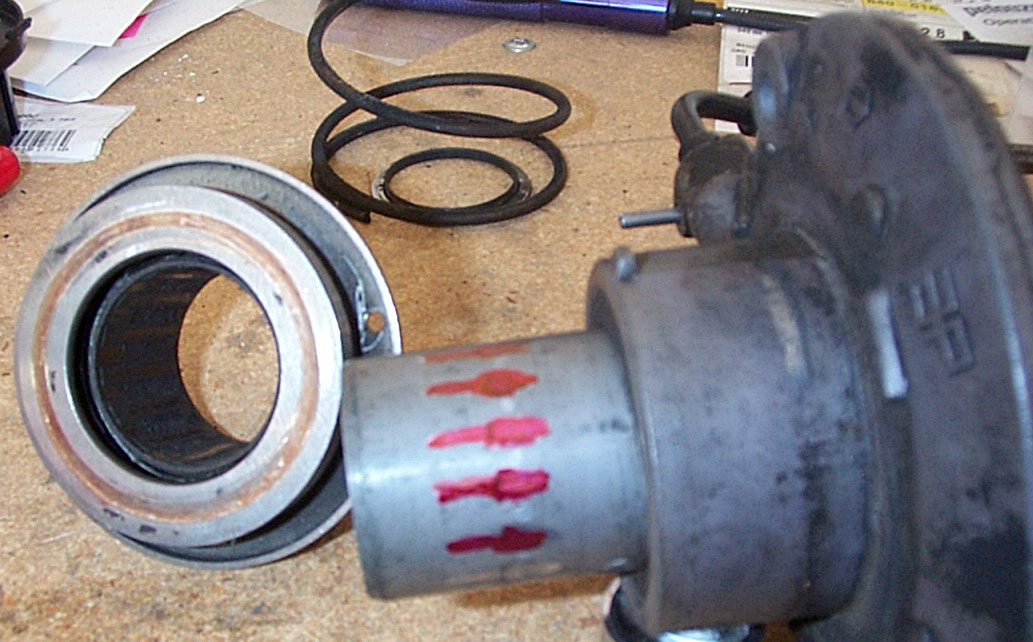

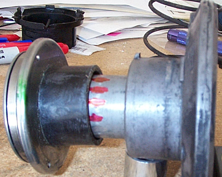

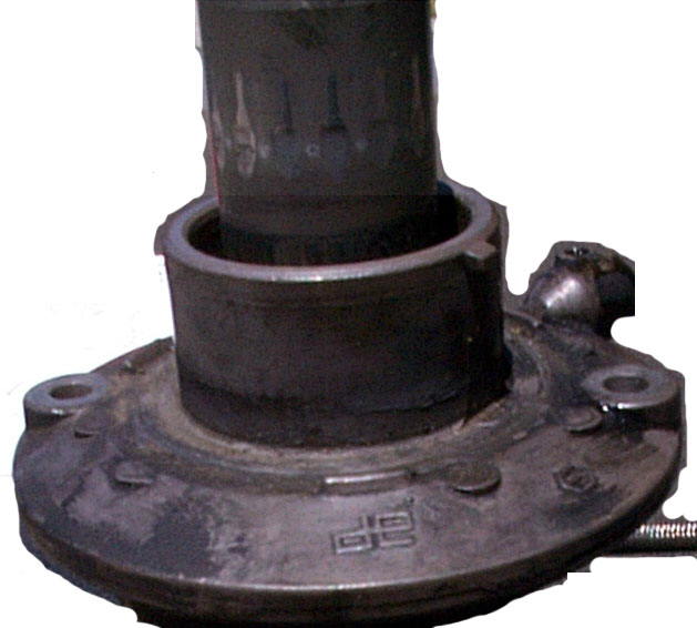

#2701 - 07/17/08 05:37 PM Re: Brake fluid cause of jammed clutch debunked [Re: teamzr1]
More images with the worn grooves painted red to better show how bearing is not sliding freely alone the stem of slave base and how bearing can be forced on a angle a jam onto stem

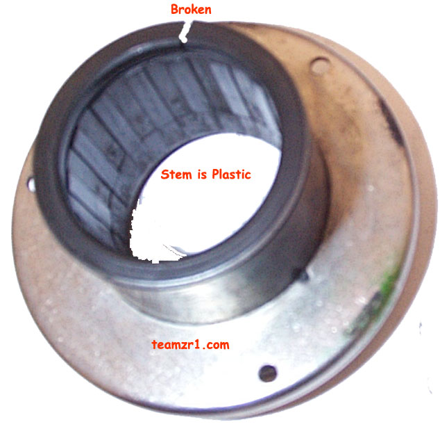

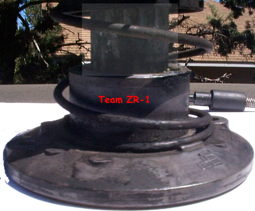

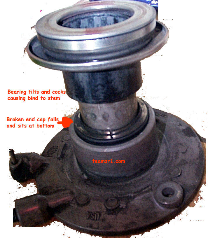

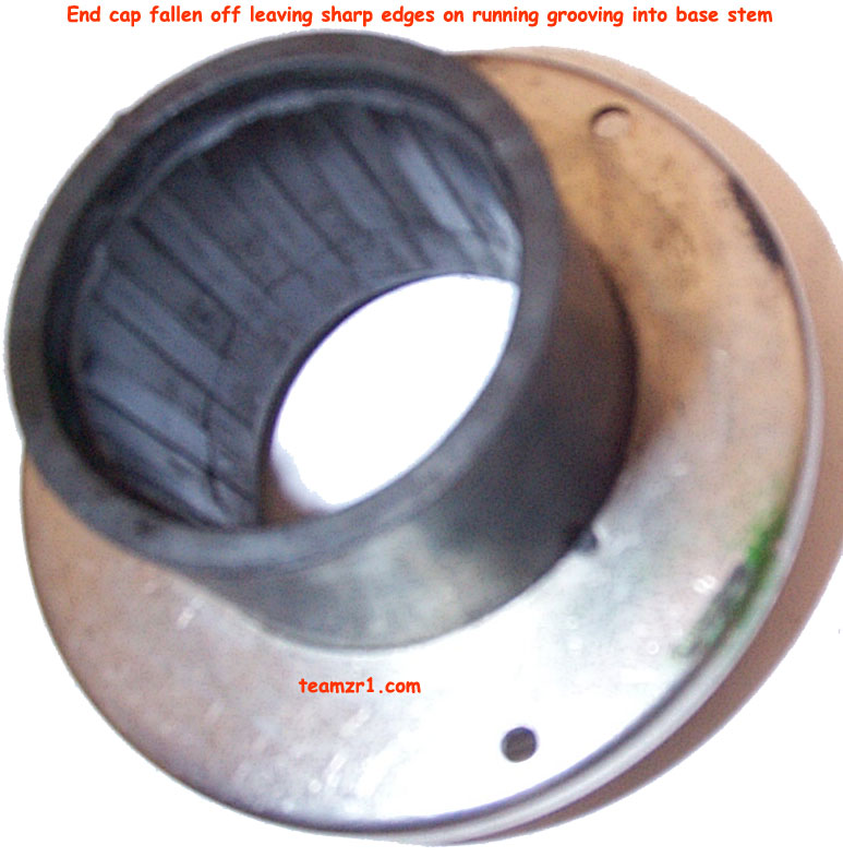

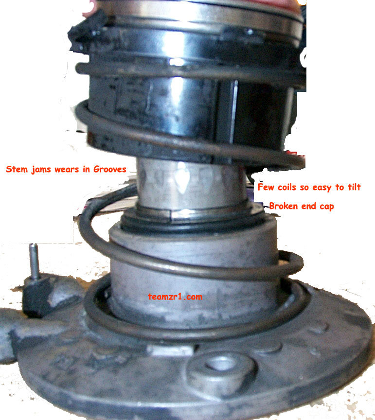

#2703 - 07/18/08 01:48 PM Re: Brake fluid cause of jammed clutch debunked [Re: teamzr1]
On examining slave more what we find is the stem of release bearing is made of plastic.
On the bottom of it is a thin metal end cap that prevents the inner grooves ends from hitting slave stem and also prevents bearing stem from tilting.
This end cap broke, fell off and now lays at the bottom where seal to fluid in base is.
This then causes bearing to tilt, jam against slave base so it cannot move smoothly and then grind grooves into that base stem.
