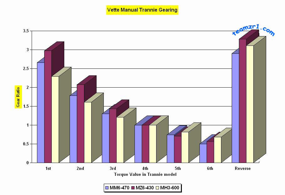

Here is a graph to make it easier to compare ratios and I included the max torque each can handle in the model name.
