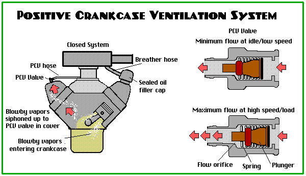

HOW PCV WORKS
The major component in the PCV system is the PCV valve, a simple spring-loaded valve with a sliding pintle inside.
The pintle is tapered like a bullet so it will increase or decrease airflow depending on its position inside the valve housing. The movement of the pintle up and down changes the orifice opening to regulate the volume of air passing through the PCV valve.
The PCV valve is typically located in a valve cover or the intake valley, and usually fits into a rubber grommet.
The location of the valve allows it to pull vapors from inside the engine without sucking oil from the crankcase (baffles inside the valve cover or valley cover deflect and help separate droplets of oil from the blowby vapors).
A hose connects the top of the PCV valve to a vacuum port on the throttle body, carburetor or intake manifold. This allows the vapors to be siphoned directly into the engine without gumming up the throttle body or carburetor.

HOW PCV FLOW CHANGES WITH ENGINE SPEED & LOAD
The flow rate of a PCV valve is calibrated for a specific engine application. For the system to function normally, therefore, the PCV valve must adjust the flow rate as operating conditions change.
When the engine is off, the spring inside the valve pushes the pintle shut to seal the crankcase and prevent the escape of any residual vapors into the atmosphere.
When the engine starts, vacuum in the intake manifold pulls on the pintle and sucks the PCV valve open. The pintle is pulled up against the spring and moves to its highest position. But the tapered shape of the pintle does not allow maximum flow in this position. Instead, it restricts flow so the engine will idle smoothly.
The same thing happens during deceleration when intake vacuum is high. The pintle is pulled all the way up to reduce flow and minimize the effect of blowby on decel emissions.
When the engine is cruising under light load and at part throttle, there is less intake vacuum and less pull on the pintle. This allows the pintle to slide down to a mid-range position and allow more airflow.
Under high load or hard acceleration conditions, intake vacuum drops even more, allowing the spring inside the PCV valve to push the pintle valve even lower to its maximum flow position.
If blowby pressure builds up faster than the PCV system can handle it, the excess pressure flows back through the breather hose to the air cleaner and is sucked back into the engine and burned.
In the event of an engine backfire, the sudden rise in pressure inside the intake manifold blows back through the PCV hose and slams the pintle shut. This prevents the flame from traveling back through PCV valve and possibly igniting fuel vapors inside the crankcase.

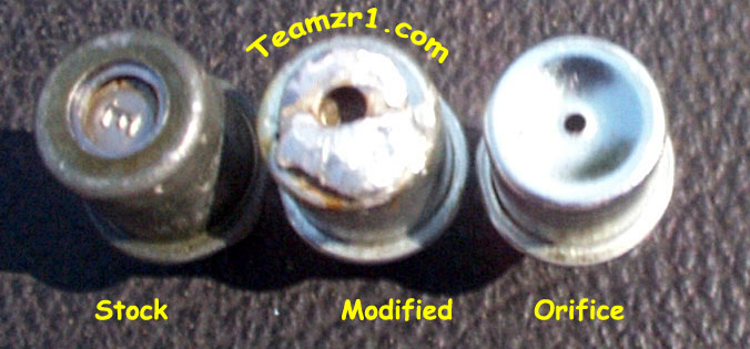

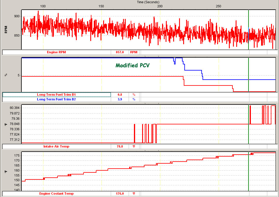

Here is scanner data as we test at idle with PCV, stock, stock modified with a smaller hole and the orifice only type.
As seen stock PCV used was leanest at idle, then reducing the hole size of stock PCV from 5/16 inch to 3/16 less rich and then with orifice type richest idle.
PCV flow then effects fuel trims.
We'll test the modified stock PCV for awhile and see if it effects less oil flow into intake, any negtive to engine seals and gaskets and what effects to air/fuel.
Stock orifice type of GM's used 2003 pickups I think the hole is too small and I think the pintel value is safer.

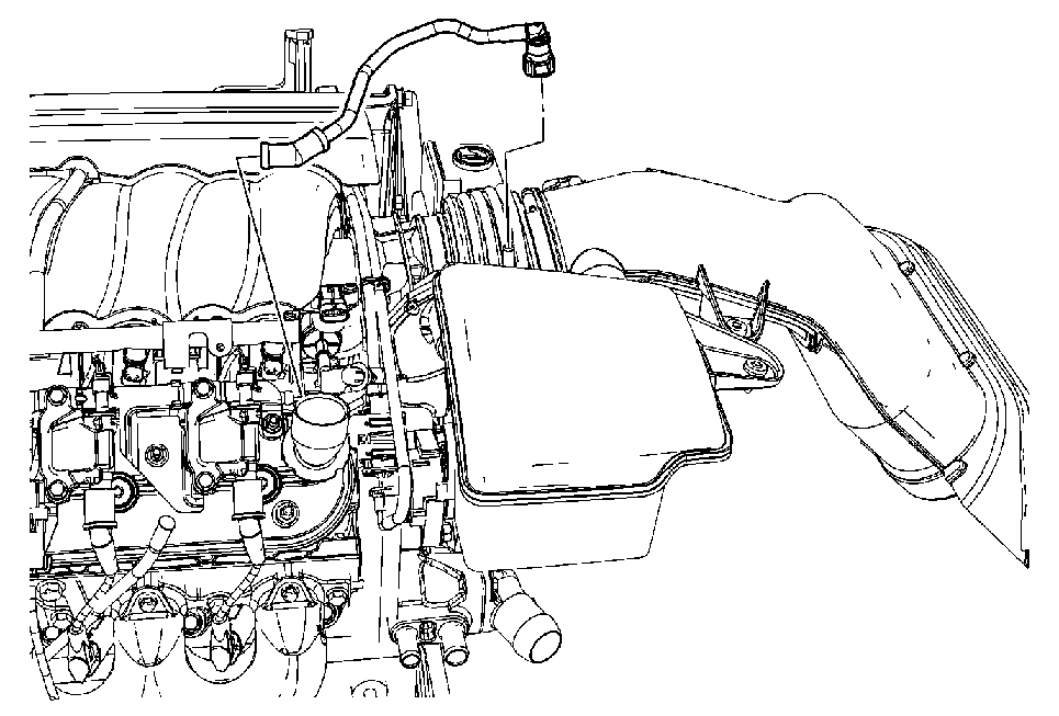

The LS7 engine utilizes an integral positive crankcase ventilation (PCV) system which is located in the engine valley cover beneath the intake manifold.
The engine valley cover contains composite oil separating baffles and PCV plumbing. Filtered fresh air is routed from up stream of the throttle plate to the engine oil tank where it mixes with crankcase gasses and is passed to both engine rocker arm covers.
The design of the rocker cover shields rocker arm oil spray thereby reducing the potential for oil being drawn back into the tank during backflow of the ventilation system.
Blow-by vapors are routed from the valley cover through a fixed orifice (2.5 mm) within a steel PCV tube, then through a formed nylon hose before entering the intake manifold behind the throttle body.
As shown though time GM redesigned how the PCV was designed and routed.
Uppper image would be for like a C5 where newer C6s such as the ZR1 middle image and LS7 bottom image shows quite different.

I replaced the original PCV valve with an orifice of 2.4 mm (homemade).
I haven't noticed any difference in fuel trims nor in idle quality.
It was just necessary to reset the PCM and perform an idle relearn procedure.
I have a catchcan between orifice and intake manifold: it doesn't collect more oil than with the PCV valve.
Important: between the orifice and the intake manifold I had to install a checkvalve because the engine is supercharged.

2.4 mm is larger then the stock orifice type GM uses.
In my testing I went so far as to reset fuel trims for every test and it is clear by reducing air into the crankcase and venting the fumes that fuel trims were effected.
Depneding on drive style would dictate how open or closed the PCV is and then the effect of air/fumes into the intake to effect fuel trims.

Because where is the return of PCV ?
Into the intake manifold with air and oil fumes.
That is why a PCV has a spring loaded pintle valve to control when and how open that flow path is.
The more blowby being sent into intake that air/oil will effect in the end what the front O2s report and of course the more oil fume volume the worse the charge in cylinder.
Also the smaller the hole is as in orifice type the more unburned fuel and oil fumes end up in cylinders to reburn, cause backfire and changing AFR

OK I didn't consider oil vapours as something that would affect the O2's, that's possible. But really, is it that much?
In my case installing an orifice didn't change the fuel trims nor the idle quality, but it may depend on the engine.
I understand the PCV valve is important in a carburated car, where the idle quality is affected by "false air" coming from the crankcase. In this case it's good to have a PCV valve that closes completely at low manifold pressures.
But with a car with an idle pintle... I think an orifice should be good enough. The amount of false air is compensated by the idle pintle (assuming the idle relearn procedure is correct).
What is the reason for GM to install an orifice in certain truck engines?

Truck PCV design is totally different then with a LS1 and 1 purpose of the small orifice was simply to reduce oil loss via this smog device.
It is common for LS1 engines to go through 1 quart oil or more per 1,000 miles and if racing lets say at the drags can use 1 quart in 5-6 passes.
You surely have to see that oil fumes replacing air/fuel into the cylinder would affect the quality of cylinder volume, the effects of that oil buring and causing high carbon buildup in cylinders and piston tops and the ill effect to what makeup the exhaust is as to what 02s are seeling less oxygen content.
Using a lightweight oil such as 5W30 in summer heat and high RPMs is easy to become blowby and out the PCV system.
