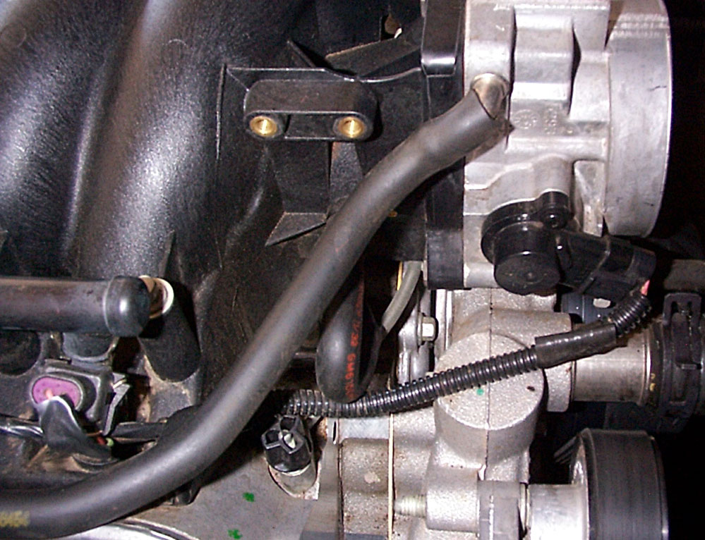

Here we can see by 2004 GM did away with most of the PCV system as seen all the hosing from right head to left head is gone.
A plug fills the hole where PCV hose went to left head and only 1 hose goes into right head and then inside valley pan is 1 hose that then inputs fumes into the intake
