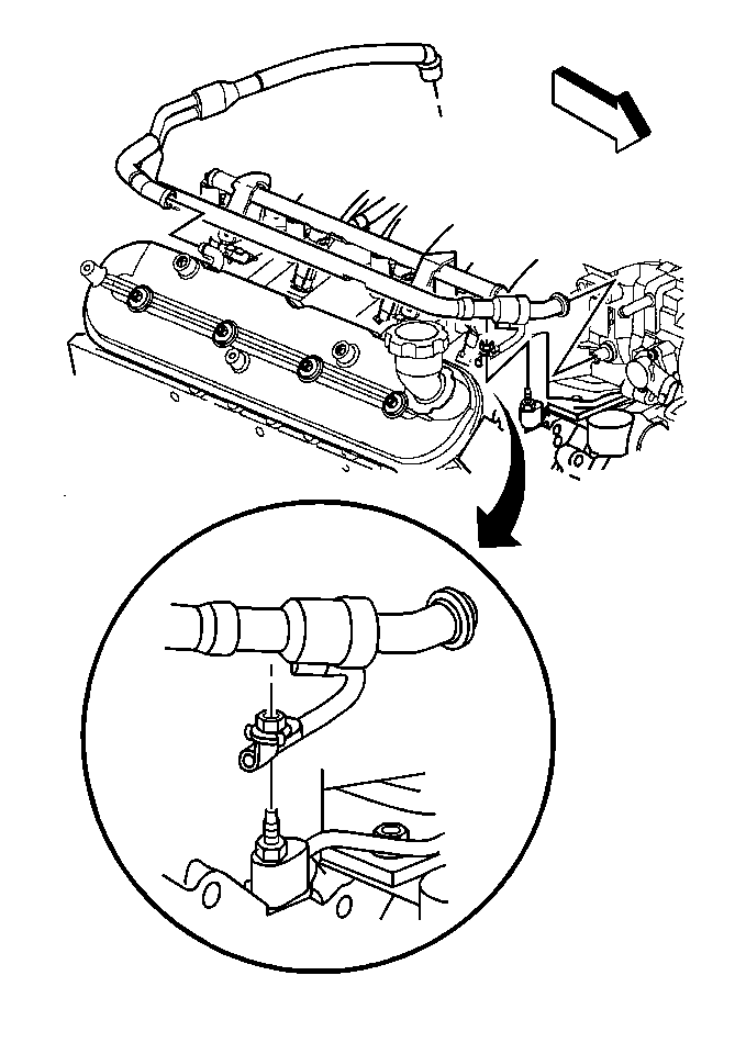

Crankcase Ventilation System Description (Without LS9)
A closed crankcase ventilation system is used in order to provide a more complete scavenging of crankcase vapors. Filtered air from the air induction system duct is supplied to the crankcase, mixed with blow-by vapors, and passes through a crankcase ventilation metering device before entering the intake manifold.
The primary component in the positive crankcase ventilation (PCV) system is the PCV flow metering device (valve or orifice). Vacuum changes within the intake manifold result in flow variations of the blow-by vapors.
If abnormal operating conditions occur, the design of the PCV system permits excessive amounts of blow-by vapors to back flow through the crankcase vent tube and into the engine induction system to be consumed during normal combustion.
This engine ventilation system design minimizes oil consumption and significantly reduces the potential for oil ingestion during vehicle limit handling maneuvers.
LS7 Engine
The LS7 engine utilizes an integral positive crankcase ventilation (PCV) system which is located in the engine valley cover beneath the intake manifold.
The engine valley cover contains composite oil separating baffles and PCV plumbing. Filtered fresh air is routed from up stream of the throttle plate to the engine oil tank where it mixes with crankcase gasses and is passed to both engine rocker arm covers.
The design of the rocker cover shields rocker arm oil spray thereby reducing the potential for oil being drawn back into the tank during backflow of the ventilation system.
Blow-by vapors are routed from the valley cover through a fixed orifice (2.5 mm) within a steel PCV tube, then through a formed nylon hose before entering the intake manifold behind the throttle body.
As shown though time GM redesigned how the PCV was designed and routed.
Uppper image would be for like a C5 where newer C6s such as the ZR1 middle image and LS7 bottom image shows quite different.

The air entering the crancase comes from a fitting of the throttle body: this air has been measured by the MAF. I don't understand why a different PCV valve diameter or orifice should affect fuel trims.
My catchcan is working for sure because I empty it every 2000 miles (more or less): the content is about 50 ml of oil.
This is the catchcan: the orifice is inside of the inlet fitting on the left. On the right side there is a checkvalve, that hose continues to the fitting in the intake manifold.
[Linked Image]
[Linked Image]
[Linked Image]
[Linked Image]

Because where is the return of PCV ?
Into the intake manifold with air and oil fumes.
That is why a PCV has a spring loaded pintle valve to control when and how open that flow path is.
The more blowby being sent into intake that air/oil will effect in the end what the front O2s report and of course the more oil fume volume the worse the charge in cylinder.
Also the smaller the hole is as in orifice type the more unburned fuel and oil fumes end up in cylinders to reburn, cause backfire and changing AFR
Here is a small filter I just stuck in to do some testing of a filtered small can in series with PCV and intake.
