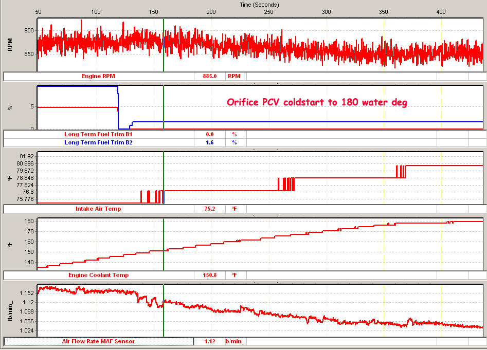

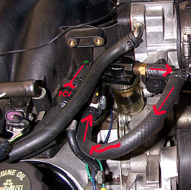

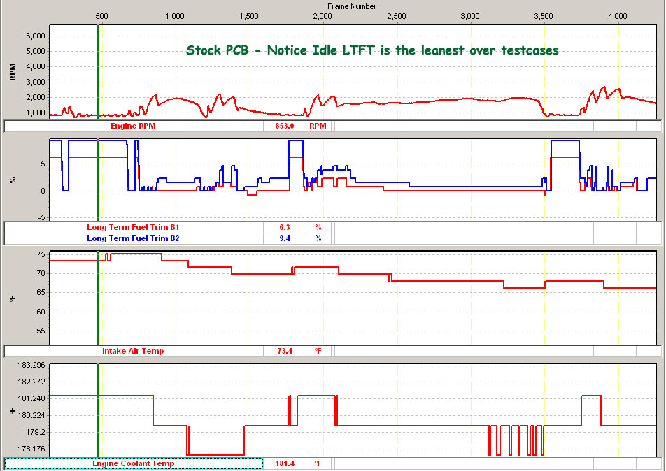

Here is scanner data as we test at idle with PCV, stock, stock modified with a smaller hole and the orifice only type.
As seen stock PCV used was leanest at idle, then reducing the hole size of stock PCV from 5/16 inch to 3/16 less rich and then with orifice type richest idle.
PCV flow then effects fuel trims.
We'll test the modified stock PCV for awhile and see if it effects less oil flow into intake, any negtive to engine seals and gaskets and what effects to air/fuel.
Stock orifice type of GM's used 2003 pickups I think the hole is too small and I think the pintel value is safer.
Attached Files pcvs.jpgstockpcv.jpg316PCV.jpgorificepcvcoldidle.jpgpcvcatch.jpg

I replaced the original PCV valve with an orifice of 2.4 mm (homemade).
I haven't noticed any difference in fuel trims nor in idle quality.
It was just necessary to reset the PCM and perform an idle relearn procedure.
I have a catchcan between orifice and intake manifold: it doesn't collect more oil than with the PCV valve.
Important: between the orifice and the intake manifold I had to install a checkvalve because the engine is supercharged.

2.4 mm is larger then the stock orifice type GM uses.
In my testing I went so far as to reset fuel trims for every test and it is clear by reducing air into the crankcase and venting the fumes that fuel trims were effected.
Depneding on drive style would dictate how open or closed the PCV is and then the effect of air/fumes into the intake to effect fuel trims.

The air entering the crancase comes from a fitting of the throttle body: this air has been measured by the MAF. I don't understand why a different PCV valve diameter or orifice should affect fuel trims.
My catchcan is working for sure because I empty it every 2000 miles (more or less): the content is about 50 ml of oil.
This is the catchcan: the orifice is inside of the inlet fitting on the left. On the right side there is a checkvalve, that hose continues to the fitting in the intake manifold.

Because where is the return of PCV ?
Into the intake manifold with air and oil fumes.
That is why a PCV has a spring loaded pintle valve to control when and how open that flow path is.
The more blowby being sent into intake that air/oil will effect in the end what the front O2s report and of course the more oil fume volume the worse the charge in cylinder.
Also the smaller the hole is as in orifice type the more unburned fuel and oil fumes end up in cylinders to reburn, cause backfire and changing AFR
Here is a small filter I just stuck in to do some testing of a filtered small can in series with PCV and intake.

OK I didn't consider oil vapours as something that would affect the O2's, that's possible. But really, is it that much?
In my case installing an orifice didn't change the fuel trims nor the idle quality, but it may depend on the engine.
I understand the PCV valve is important in a carburated car, where the idle quality is affected by "false air" coming from the crankcase. In this case it's good to have a PCV valve that closes completely at low manifold pressures.
But with a car with an idle pintle... I think an orifice should be good enough. The amount of false air is compensated by the idle pintle (assuming the idle relearn procedure is correct).
What is the reason for GM to install an orifice in certain truck engines?
#2691 - 07/07/08 02:49 PM Re: Positive Crankcase Ventilation [Re: ]
Truck PCV design is totally different then with a LS1 and 1 purpose of the small orifice was simply to reduce oil loss via this smog device.
It is common for LS1 engines to go through 1 quart oil or more per 1,000 miles and if racing lets say at the drags can use 1 quart in 5-6 passes.
You surely have to see that oil fumes replacing air/fuel into the cylinder would affect the quality of cylinder volume, the effects of that oil buring and causing high carbon buildup in cylinders and piston tops and the ill effect to what makeup the exhaust is as to what 02s are seeling less oxygen content.
Using a lightweight oil such as 5W30 in summer heat and high RPMs is easy to become blowby and out the PCV system.
