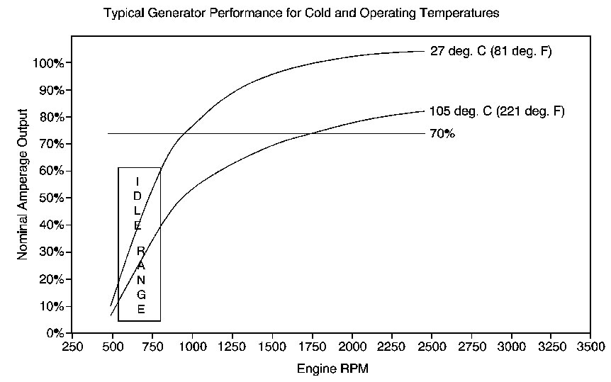

• At idle, vehicle electrical loads may exceed the low speed current (amperage) output of the generator and when this happens the shortfall comes from the battery. This will result in a drop in the electrical system voltage as the battery delivers the additional electrical current to meet the demand. This is equivalent to the brown outs experienced by homes and businesses when the electrical demand is more than the supply. See Figure 1.

Depending on the vehicle application, generator current (amperage) output at engine idle speeds of 600-700 RPM can be as low as 35 percent of the full rated output. With enough electrical loads "ON", it is easy to exceed the generator current (amperage) output when the engine is at an idle of 600-700 RPM. This is a normal condition. The battery supplements for short periods of time. Items that affect the vehicle's electrical system current and voltage at idle are the number of electrical loads being used, including add-on accessories, and extended idle times.
