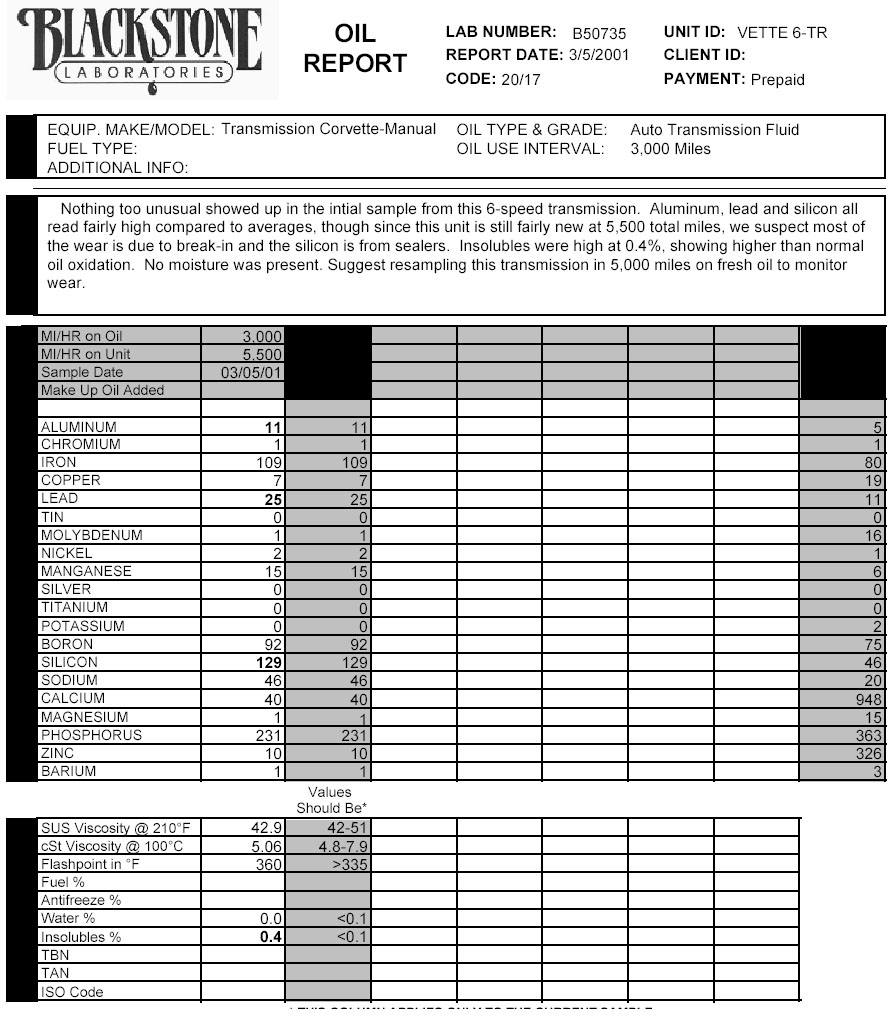

It also is wise to send out the trannie fluid to a testlab to get analyzed and also see how the internals of trannie are
These results are from after a high speed ORR in Texas heat for 120 total miles at speed and MM6 fluids got too hot and bottom results are from before the race
