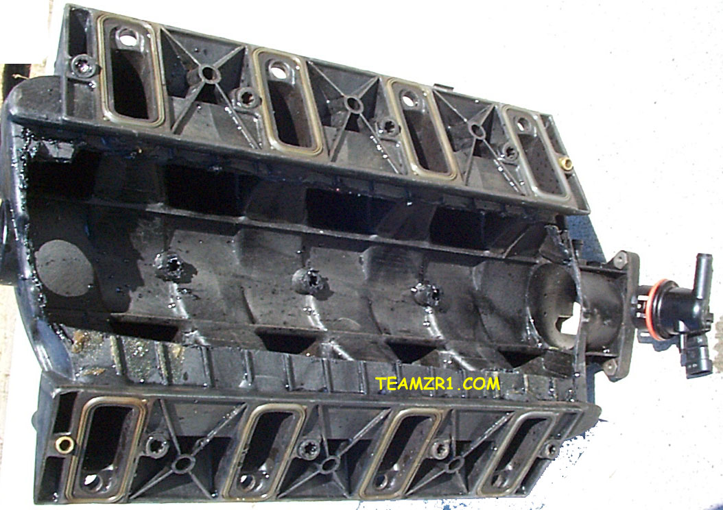

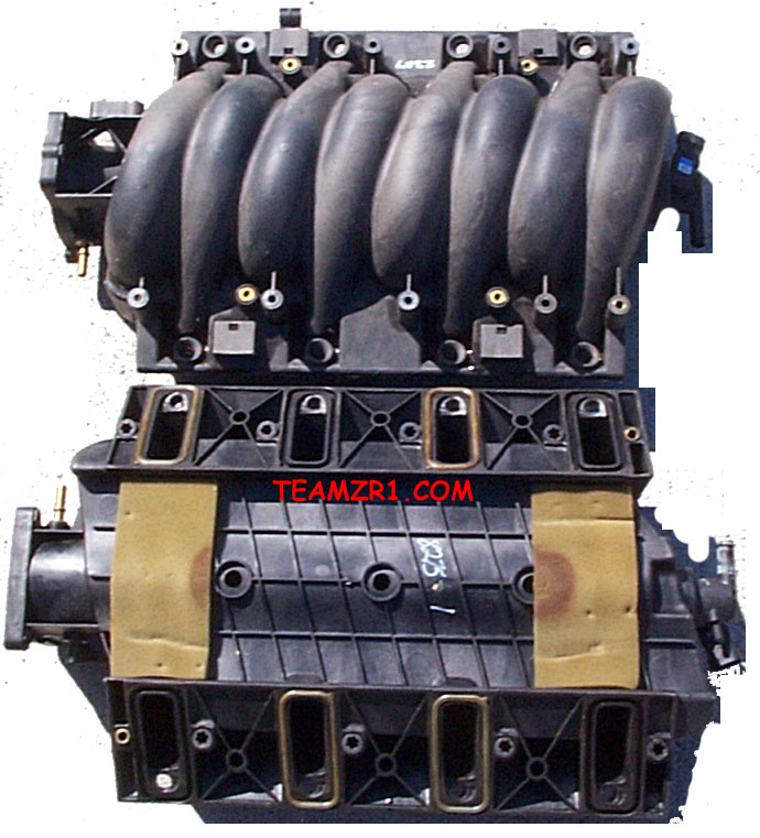

If you have not seen inside the intake manifold, here we cut open a LS1 intake.
The bottom is 3/16ths inch thick.
Notice the opening to ports 2 and 8 is smaller by 1 inch.
Runners are 12 1/2 X 2 inches
It is 2 inches from the bottom of intake to the runners.
