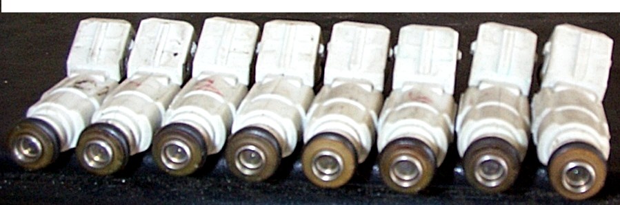

Since these injectors were in my 1999 C5 since 2001 I took them out to see how they have stood up all this time and they were just fine.
Nozzle holes were clean and it looked like the filters inside were also OK.
